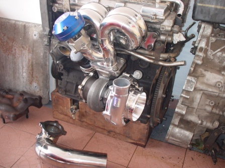

Attached here is a custom built SS turbo header with equal length thick walled ( 2.2 mm ) for my GT-3037 turbo.:proud:
I ordered this SS header + down pipe for less than RM2K from Bangkok, delivered to my door step - no tax.
The OEM hdr weigh 7kg. where else the SS hdr. weigh 5 kg. 2 Kg saving in weight :proud:
This header is well built with 5/8" Thk. manifold flange and 1/2" turbo flange.

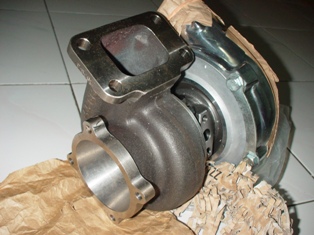

My Garette GT3037 turbo..............brand new up for offer...........this cost RM5K today.
Reason, I have another turbo at TOM's which I could use and it only weighs 6Kg as compared to GT3037 which weighs 8Kg.

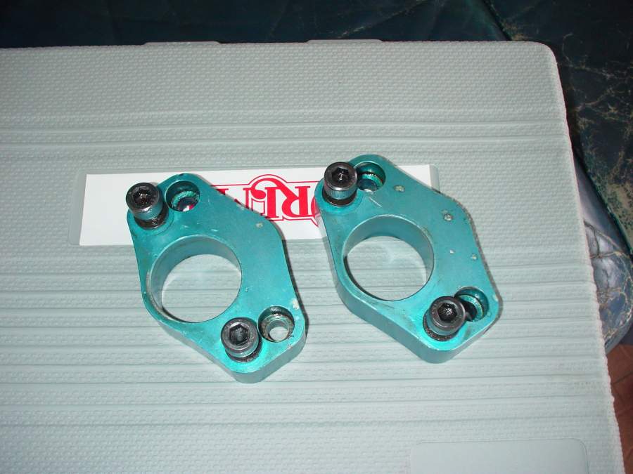

Hi,....back again in my project, completed today in lowering my MR2 the proper way...........
Installed the RCA on the front arms. Highly recommended for all who lowered their cars. This RCA helps to correct back the arms' geometry to reduce oversteer of the car. Without the RCA and the car lowered, the front wheel will tend to go to positive camber when taking a sharp corner and this is dangerous. See attached photo.....

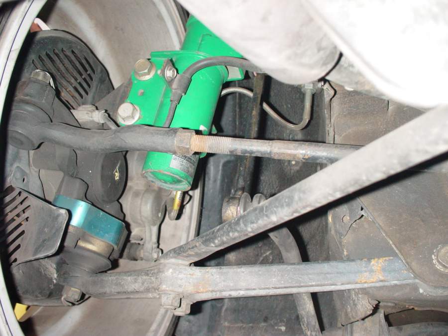

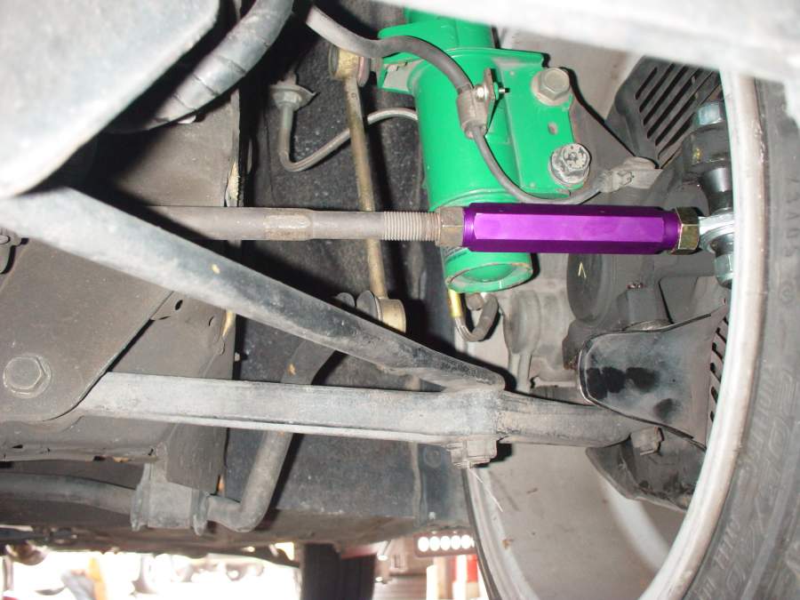

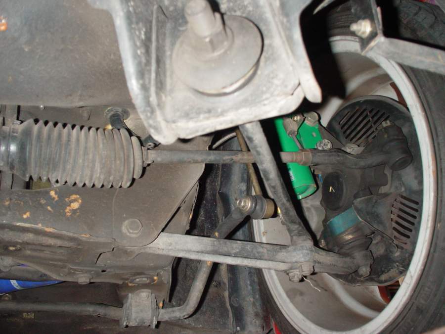

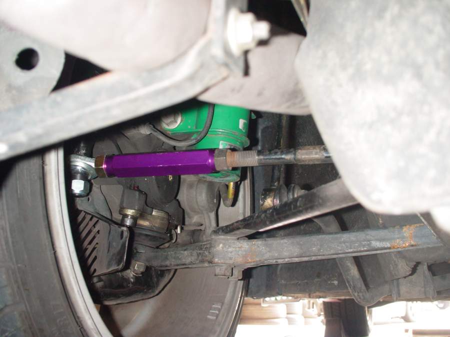

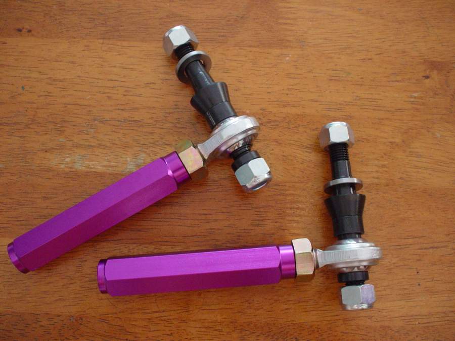

Next, tackle the toe in problem when lowering the MR2. MR2 has a unique setup with the steering rack installed in front of the front wheel where else all other cars ( Evo, RX, STI, Protons, and others daily vehicles ) have their steering rack installed behind the front wheel. ( I believe the designer did it with a purpose ie. to make it oversteer.) When the car is lowered, both left & right side steering rack end points upwards. During a sharp corner. The wheel moves upward further thus causing the steering link to moves up and this pulls in the wheel and indirectly causing excessive toe in. This makes the car oversteer more and it is dangerous, ( I have experienced this B4 I write this as I have been doing some practical research on it.) Extremely dangerous in corners and you can't go fast, the tails keep wanna swing out. The solution is to install a pair of this aftermarket link end.
See attached photo #1.......This helps to bring down the link to almost parallel to the road or neutral position. So during a sharp corners, the link will not pull in too much that causes excessive toe in.
The #2 & 3 photo shows the arm with the RCA and the steering link end ( without the aftermarket link end ) pointing upward.....while the lower arms stay at neutral or parallel to the ground.
The #4 & 5 photo shows the the aftermarket link end installed and notice the it is parallel / neutral to the ground.

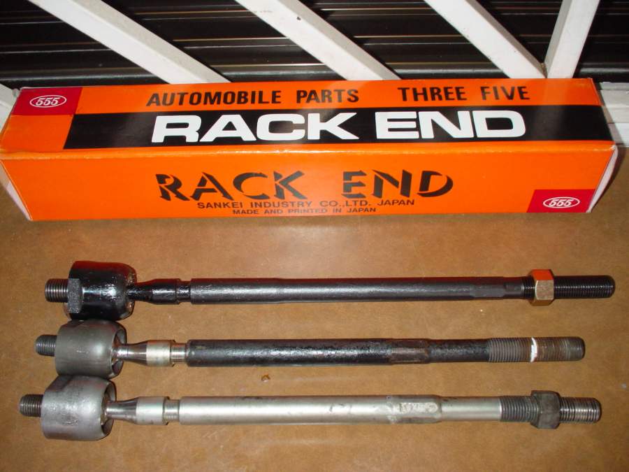

I found it, Toyota AE92 is 1 inch longer than MR2. But a different set of problem here again. The thread to the steering rack on the MR2 ori is M12 x 1.25 thread where else AE92 is a M14 x 1.5 thread. Again to find a M12 x 1.25 end rack is rather impossible as most cars uses M14 x 1.5 thread, unless to order from Wing Hin but it is just too short for this project. So have to carry out some modification to the steering rack ie. drill and retapped to M14 x 1.5 thread. The other plus point is you can use any Toyota parts which is readily available in the market as M12 is rather rare.
Photo #1 shows the AE92 end rack ( 555 brand made in Japan ).
Photo # 2 shows the difference in length........the top one is the AE92 ( 555 brand ) the 2 bottoms are the ori ones which is 1 inch shorter.
System could not accomodate photos earlier, must be a hickup or somthing else.....Here are the photos............
Photo #1 shows......AE92 end rack ( 555 Brand Made in Japan )
Photo #2 shows the difference in length.
Photo #3 & 4 shows the difference in the thread size.
Photo #5 shows the extra 1 inch length on the new rack end.
