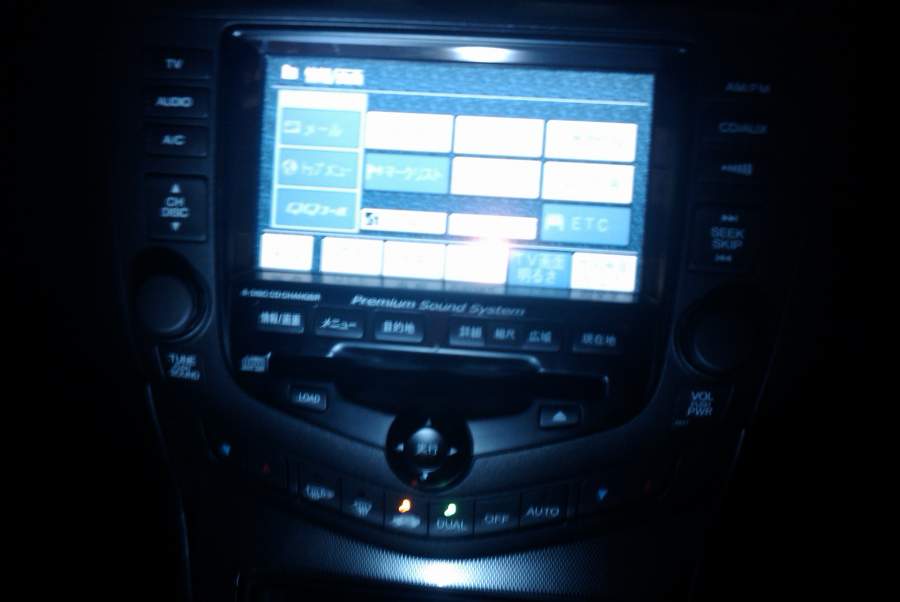

Mine is factory navi, but the time canot adjust also, is a way to fix it ?
I teach u how to adjust the clock here. press the navigation key from left no.2,4 and 5 together for about 5 sec. The the screen will appear some title. Then press the GPRS title and u will found where to adjust the time.If not clear enuf, u can call me 0198040399.
Bro, wat do you mean pres the navigation key from left no.2,4 and 5 ?? I cant find any no. here.

Time adjustment for stock JDM cl7 HU:
1) press BAS/TRE till time blink
2) press "4" adust hr
3) press "5" adjust min
4) press BAS/TRE to confirm
Time adjustment for nuvi cl7 HU (taken from CL789.com):
At the bottom of the TV monitor there are 6 buttons.
Press 3 buttons together & hold for about 3 seconds. These buttons are the 2nd one, 3rd one and the last (6th) one counted from the left.
After 3 seconds a menu should pop up.
Under this menu select "機能設定" and then select a sub-menu "GPS時刻".
Then press "+" or "-" button to adjust the clock.
This should help you set the clock on the TV monitor. Not sure about the seperate clock display on the dash.
Hope it helps.
