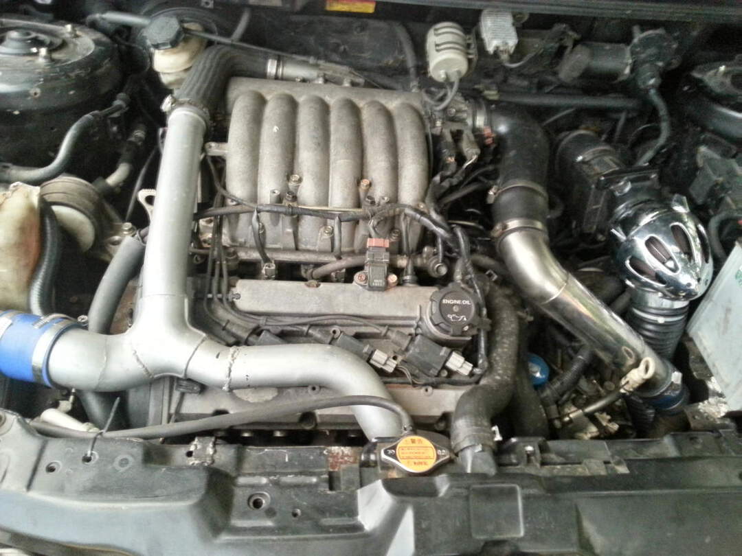

wow...it so long did not log in...my car already finished the mod but still not perfect...The gear is jerking from gear 2 to gear 3...any advice?
---------- Post added at 05:22 PM ---------- 6 hour anti-bump limit - Previous post was at 05:21 PM ----------
And last week just finished the outside cold air mod...will share the picture later
The engine

jerking happen due to several cause. spark plug kong, plug cable no good, running too lean or too rich. bring to workshop for checking.. AT can also cause a jerking.

On the jerking, it only happen on 3rd gear. Already sent to 3 wshop but they're unable to find a solution.
u need to find mechanic that are familiar with 6A12 or 6A13 engines. they are not the same as 4G63 mechanics.. try ask someone in this forum. maybe the perdana guys..
---------- Post added at 04:10 PM ---------- 6 hour anti-bump limit - Previous post was at 04:09 PM ----------
but until u find the right mechanic, get ur current mechanic to checks all the thing i just mentioned.. might solve who knows..
