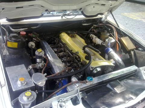

hi sifus n gurus.. a real noob here.. i juz bought a BMW E28 wit RB 25.. everythin was runnin perfect.. till last weekend.. my gear wont shift or engage.. even if i press d clutch all d way in.. d previous owner had installed nismo twin plate.. but now its so damn hard 2shift any gear when d engine is turned on.. but when its off.. d gears goes into track s smooth s velvet.. im rili not sure wats wrong.. some ppl advice me 2flush n replace my gearbox oil.. n anotha batch told me 2change d clutch.. but d clutch was changed some where around july last year.. n i dun drift or do donuts wit this car.. most of d time juz idle cruise drive.. kinda upsettin thinkin bout my baby.. i hv no otha means of transportation at d moment.. so plz dear sifus n gurus.. help me out guys.. rili appreciate ur help n advice.. n d cost of fixin d prob ASAP.. TQ TQ TQ TQ!!

if hose leak, change to steel braided..
if pump leaking, change new or buy used at chop shop..
cost depend on shop n labour charge..
i also 'kena' on my daihatsu..not RBl ahhe..he..he...who knows is a same prob?...spring at the clucth plate 'pecah'...kena turun gearbox baru tau...i ingat before that you mesti rev kaw2 punya...he..he..he..
try check your clucth pump...still got 'minyak' or not? if kosong or kurang...maybe got leak somewhere...
if ur clutch pedal falls flat to the body n wont come back up, then its the clutch pump or the hose. if ur clutch pedal works normally n still cannot engage gear, then maybe its the clutch plate or gearbox something wrong...
yes yes! my pedal wont cm up!! dats it.. but now anotha thing.. d cost 2fix it.. haihs.. n my foreman said its not easy 2 jack d car up n do... instead he needs d ramp 2 jack d car up like in exhaust shop.. then oni easier 2check d pump n hose.. thx alot guys.. rili appreciate d help
