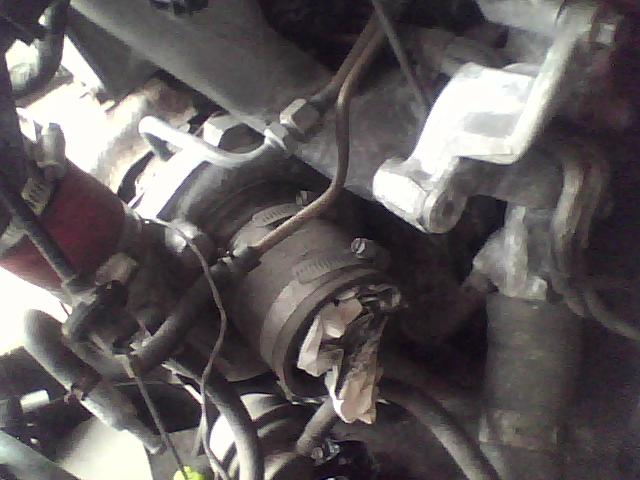

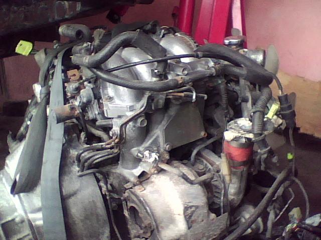

here are some pics of the engine that i have.
can someone here tell me what this engine is missing
(apart from intercooler pipings that i have taken out n wiring)
and what part(s) that has been upgraded by our friend back in japan.
from my understanding, this engine came from 1986-88 model fc

Looks like a standard 13Bt, non-GTX.
The only obvious thing to note is that the belt pulley for the water pump is changed to a double belt - the shiny purple thingie. That's a good thing and usually one of the first things owners should do.
Well, take it over to your nearest rotary mechanic, preferably Ah Choy in Subang, and have it torn-down to have a looksee inside.
And change all the silicon hoses.... And have the vacuum lines checked... and the solenoids.... and have the turbo checked to see if it still actually works...
I am assuming you dont want to do all that by yourself.
