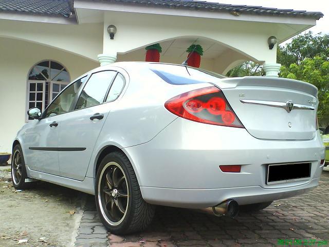

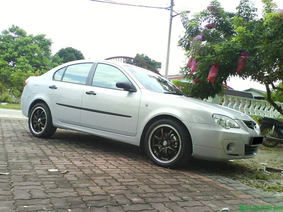

recently i had fitted 17" rim (CE28) with 215/45R17 but sad to say dat both the rear tyres sangkut when either more than 2person loaded in car or lalu bump w/o slow down (front tyre is ok, no sangkut).

Bump: da rim n tyre...
Bump: photo of da rim n tyre...

ketuk mudguard is yr last resolve, coz maybe the offset is not rite for yr rear wheel....
rare size tire bro.....but its also a simple solution, no need ketuk2...
the ride high is still balanced, the rubber damper make ur springs more stiffer...
after saw ur car pic, i've wonder...how come that kind of high still can "sangkut"?:hmmmm:

Bump: rear view photo!
Bump: i had cut off upper section of da rear arch banana cover but stil sangkut tyre.
as visual chking suspect dat kena body/mudguard!

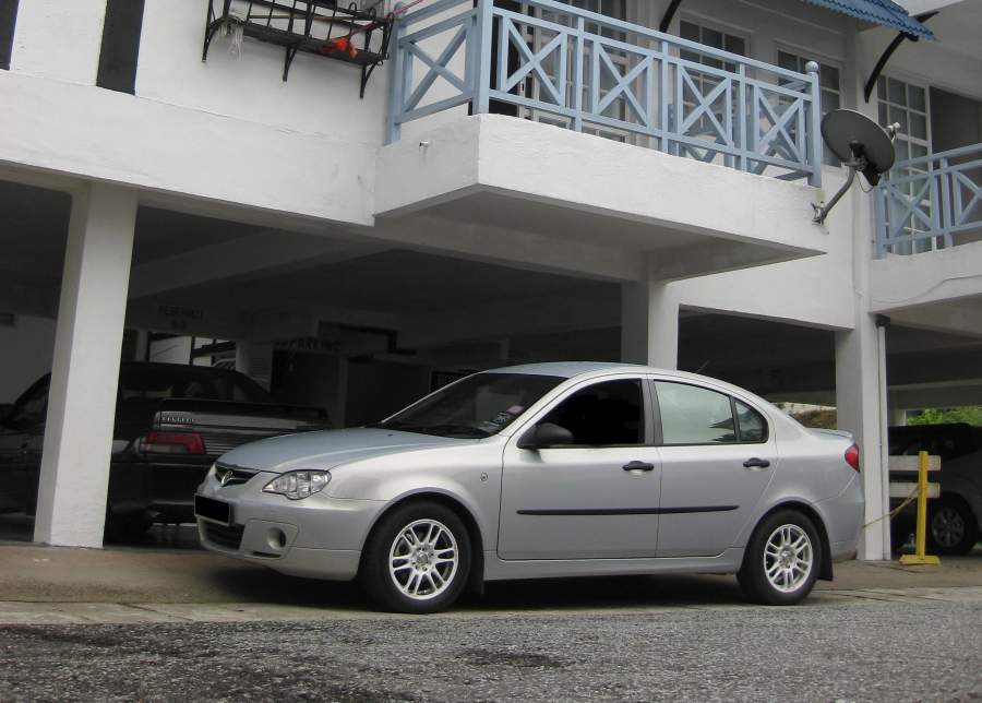

mine persona is MT. b4 tis i was usin 15" alloy wit conti tyre, when pick up, 1st n 2nd gear would spun, now 17" solved da prob.
attach herewith da photo of previous 15" rim.
