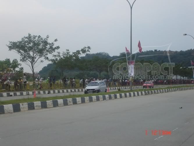

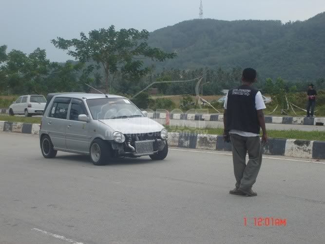

but need more to modification...........like mine..........blok using 850.......bigger piston using toyota......tdo4 vr4 turbo................boost 2bar max......already proven..........ehhehehehehhe............this my car..............
at track in bt. kawan.......
