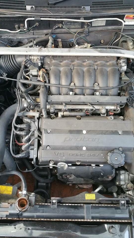

How to differentiate japan spec V6 with a proton spec?
A workshop selling me the engine for 1.5 apparently japan spec.
but the head cover on the pic is Proton like the original..:hmmmm:
Anything to look out for..
Millage 75k- reason of changing to MIVEC- MD
