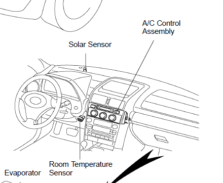

fyi.. the error might refer to this solar sensor..
solar sensor.. it captures cabin temperature input to climax/air-con system,
and use it to auto-adjust the a/c's fan-speed in 'auto' mode ?
