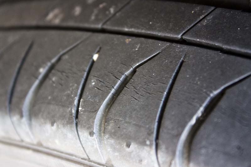

Is this cracks caused by hardening of the tyre compound?
mines998, I would love to have the rubbers you mentioned. PS3 is also my favorite being very well balanced in dry wet grip and noise level.
