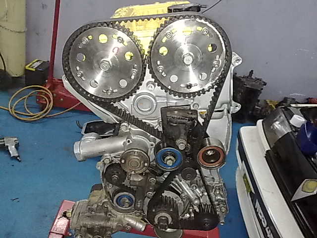

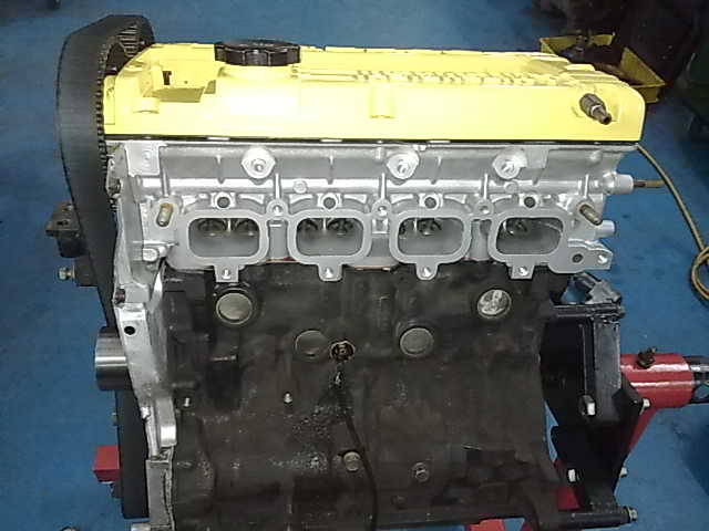

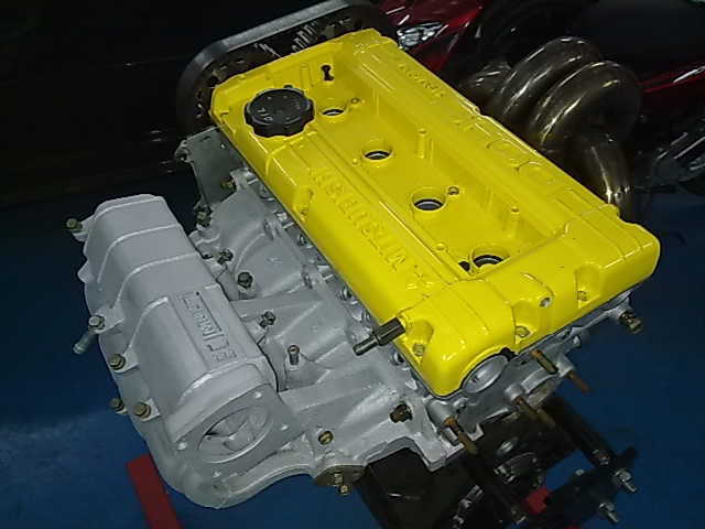

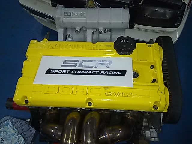

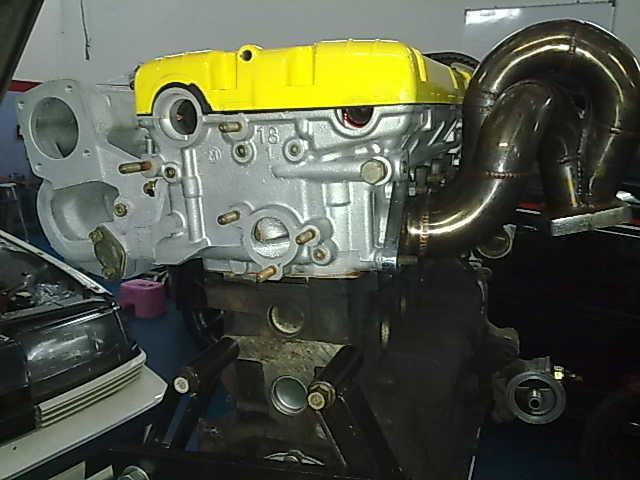

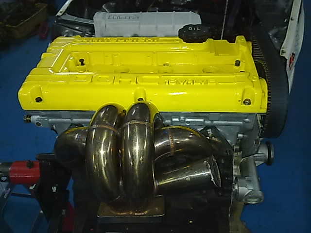

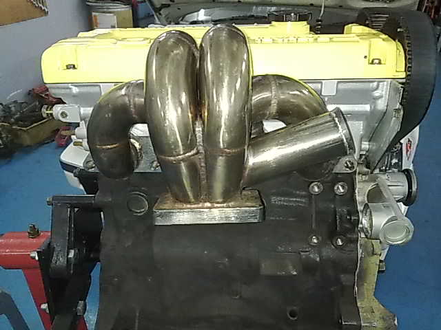

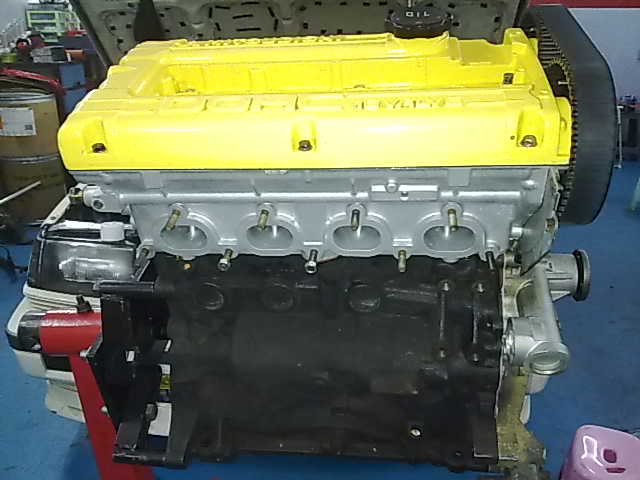

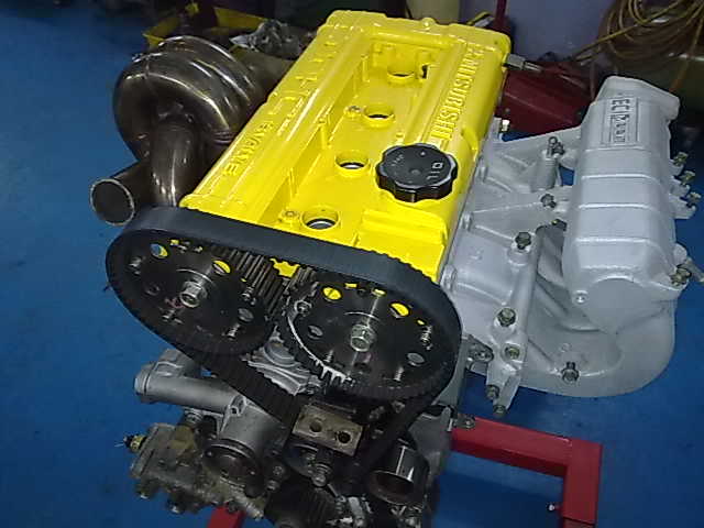

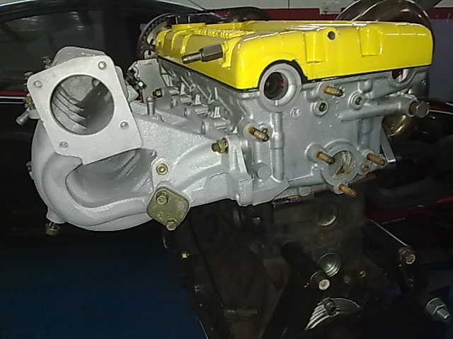

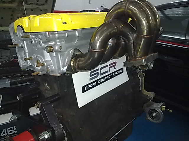

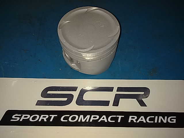

This is 400-450whp engine with normal pistons normal budget.
1.VG pistons(all clean and new ring)
2.Vr4 rods
3.850cc injectors
4.Walbro fuel pump
5.Head Cleaning
6.Oem Cam
7.Oem Intake 4G67
8.ARP head stud
9.Cometic gasket
10.Turbo Manifold
12.T3T4 turbo
13.ACL Engine Bearing

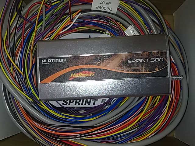

14.Haltech Platinum Sprint 500 with Tuning and dyno
Below than 20K budget.
2 or 3 weeks done.
Daily Driving 100% cool with aircond.
No Dramas at moning start and economic fuel bring your couple.:rofl:
Contact
SportCompact Racing:biggrin:
