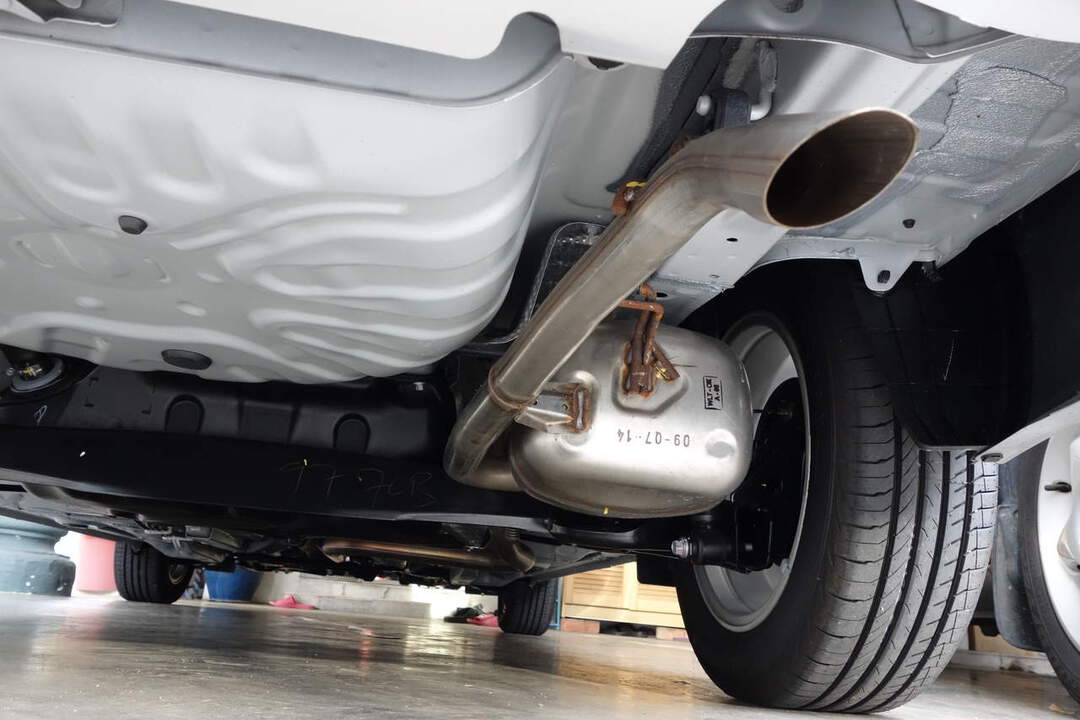

I found rusting at the exhaust silencer box in a brand new Toyota Vios that had just been purchased for less than a week. I was wondering is this actually normal or should I lodge a complaint to the service center?

normal, few of my ex brand new car encountered the same problem as well.
I guess it can't be helped then. Talking about quality, this is rather bad. Even a Wira that is more than 10 years old did not have such rust at the exhaust silencer area.
While it is normal, it is good that you rectify it. The rusty parts r the support for the exhaust. If it continue to corrode the metal, very soon it will break and you will have to spend $$. Get a high temp spray paint on it. If you are living near the sea, corrosion will happen even faster
that is right. A can of HT spray cost about 12 buck. Bring the car to SS to complain....use petrol, waste more time. Worst still, the service center says to you "Soli, this is not covered under warranty".
Save the trouble, and spray the paint over the rust, if I were you. The problem isnt worth going through all the hassle.
imho having too many welding point on the muffler is not good as it will reduce the lifespan of the part.
the weld and solid steel has no problem handling the rust.the area surrounding the weld can be rotten by rust.
its a bad situation as we are living in a country with frequent rain.if this is in the middle east then its fine.

My Chery also have some rust at the exhaust muffler, but I thought because mine was one year ago manufactured but not sold model....:smokin:
I'm a little different. I'd find out whether this is covered by warranty, if yes then I'd encourage the rusting until breaks right off and then claim a new one. Then with the new one I'd get my own antirust and protect the parts.

The salesman said every other car experiences similar rusting like this as well...

Painted it myself......:driver:

Extractor and wheel hub near disc rotor cannot be help because cast iron, sure to have rust...
