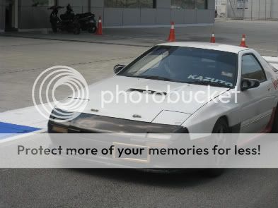

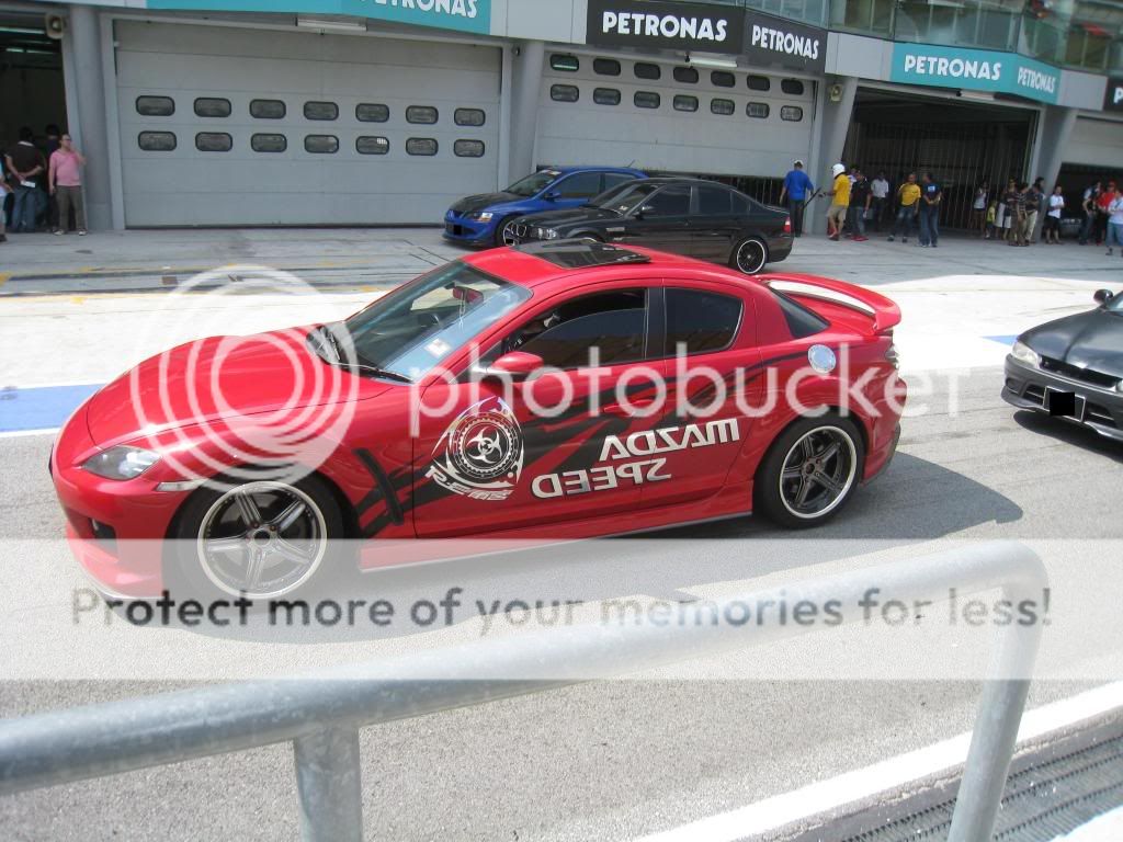

Had a blast yesterday at Sepang... sadly only saw 2 rotaries there :(
My Flying Circus and a sweet Mazda Speed RX-8 ^^
Nice RX-8
