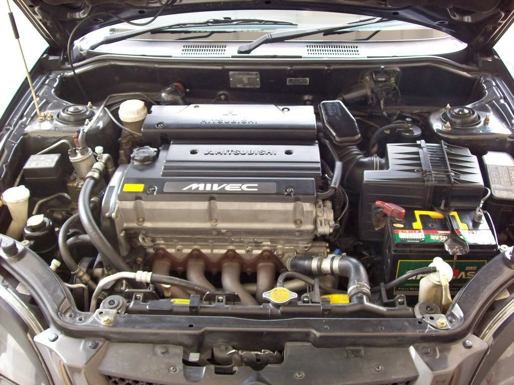

A close friend of mine had a scoupe yrs back. He put in a Mivec 1.6 from a lancer and it served him really well for abt 4yrs. He sold the car a few years ago and i've seen the car running fine till today..

http://www.zerotohundred.com/newforums/[ATTACH=full]676926[/ATTACH]

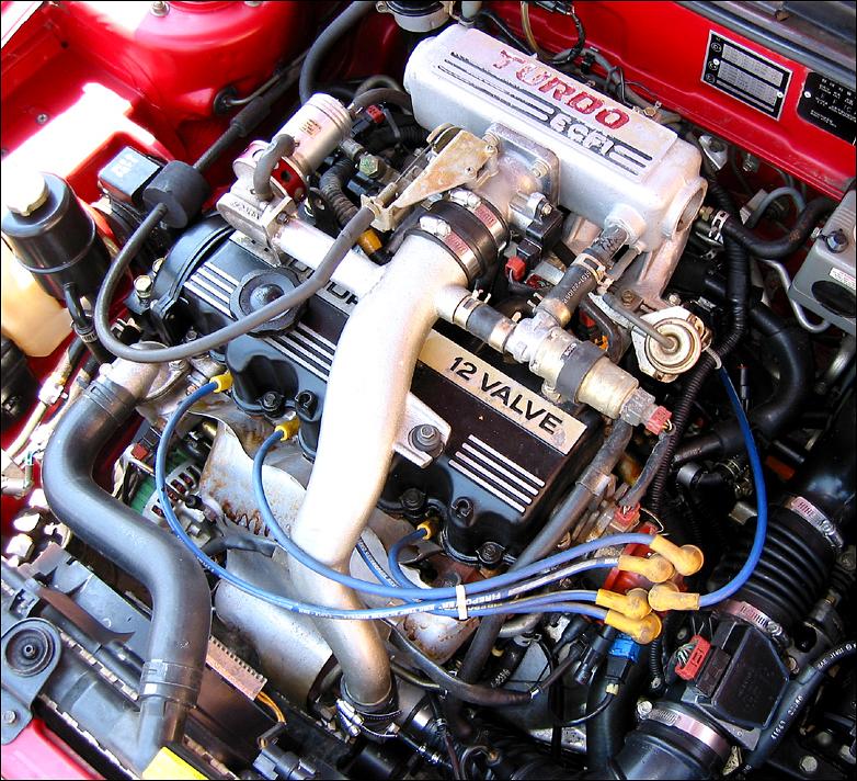

On the other hand, why don't you consider Scoupe GT turbo engine or convert current engine to GT turbo spec? This is how a Scoupe show car should look on the engine department:
