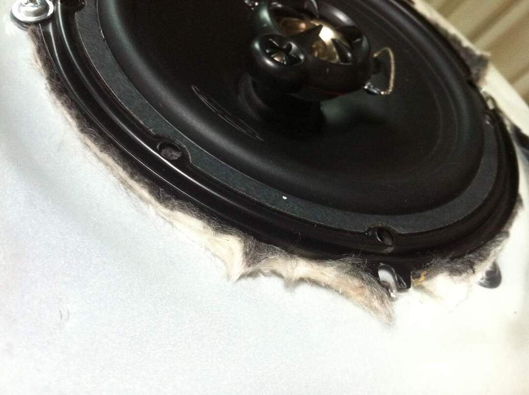

I used this kind of wool insulation as they are soft and a good damper material. They are available at most accessories shop or even some hardware shops. CAUTION: CAN CAUSE YOU SCRATCH YOUR BODY LIKE A MONKEY (ITCHINESS).
2.
I cut 4 small pieces and stuff them in between the speaker rim and the door panel. This is to absorb vibration from the speaker to the door panel.

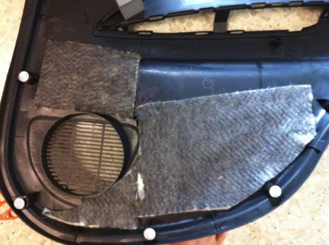

This is the inner door panel of a Perodua Myvi Lagi Best. Notice the big area beside the speaker sound mesh...that's the area where vibrations is the most as the plastic is thin and has no reinforcements.
4.
Using double side tape, i pasted the insulation to where it should be..the thin and flappy plasticky area. Put the door panel back on and job done ! I have also pasted some DEADENING sound insulation at the metal side of the door...coz I have some left from my previous car. Helps out abit :rolleyes:
