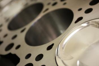

Make the good stuff for hold 650whp on your stock block 4G63T 2.0L.No Stroker kit what we make it.With a good budget and engine realiable we run with Manley Rod,Forged Ross Pistons,Stock Crank and ACL Race engine and Rod bearing.You can save a cost,and get the stuff around RM 6500.Hope Everybody can do it what we done before.:biggrin:

that's a good news 4 turbo owners... less money more power...

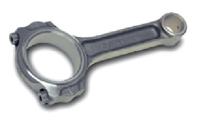

Manley xpencive than Scat.Scat have 2 time forging for metal with a good budget.Also he can do a forged rod same like factory rods.We can get the best price RM1600 for your door step.This rods can hold power 750whp with out no dramas.

Bump: The forged rods are not coming from CHINA.Only the box from china.U can compare the material.China made have a rusty,but USA no.China is a good copy in the world.

6 bolt or 7 bolt?

Bro,
what is 2 time forging?
How do we compare material side by side , if it is from China or USA? by looking at the rust? All steel rust regardless where they are made from. The common steel that does not rust in the industry is stainless steel or aluminium. Care to share how to compare?

You can compare if you ask the forged rods manufacturer for the mill certificates. On the mill certs you can see which country the mill is situated, what the properties make up the alloys.
You can further compare by conducting a bend test for the forged rods. See which one breaks first.
