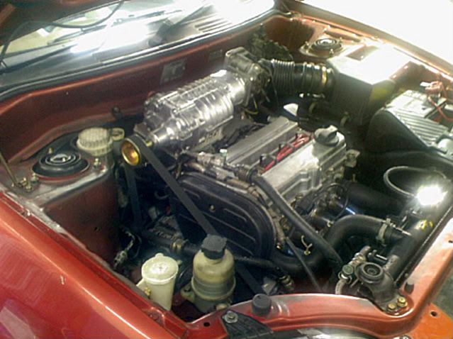

found this thru google images. RM16k setup, unless the price has changed...

the supercharger part I've seen before, VectorX2, I'm wondering how they drive the supercharger pulley. without removing a/c or power steering. the picture you've shown shows a LONG belt lol.. I wonder how's the maintainance on those is.. AFAIK, longer belt = easier to strech = shorter life...
attachment.php
by looking at the lay out of the pulleys, i think that it would be possible to guide the belt like an L shape starting from the alternator pulley by hinging a guide roller above and before the alternator pulley, what ya guy's tink? :biggrin:
