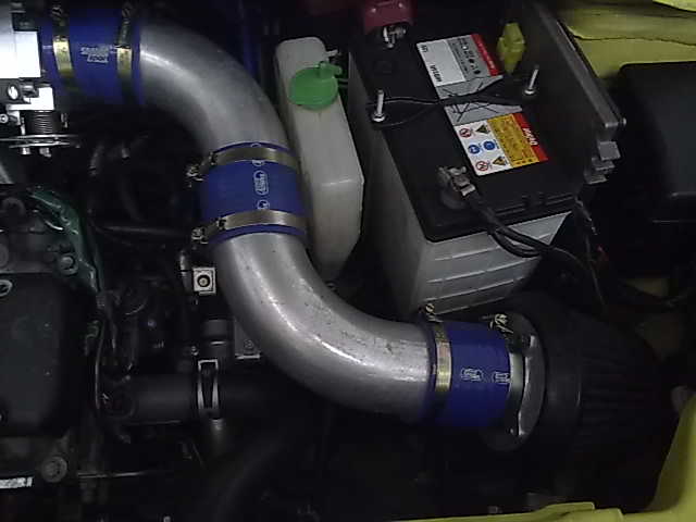

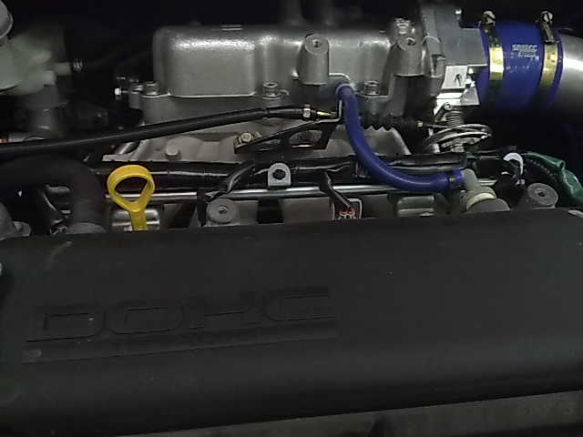

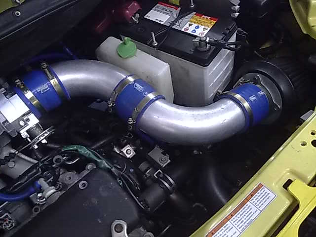

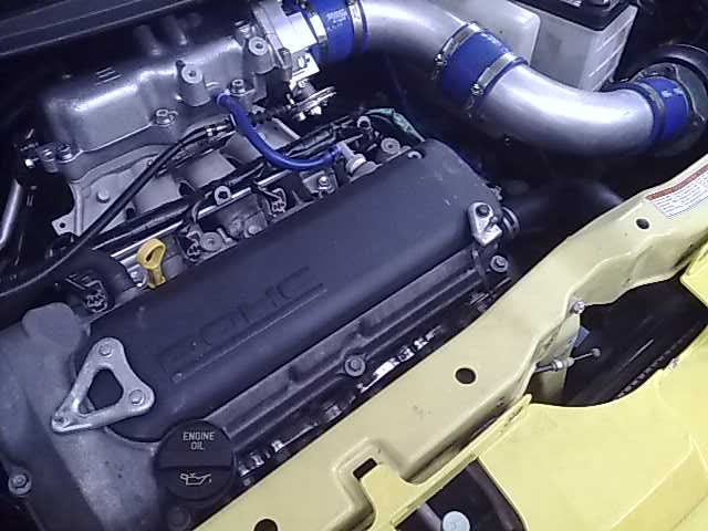

Just Finish tuning the sporty engine at dyno dynamic.The engine get the 147.4whp.Running petronas 95 octane fuel and not much ignition timing.This engine can moving like a Hayabusa.
Wait for the 2nd tuning to target 155-160whp pump race gas Q16.

bro without inner shim replacement set, u r confident to run on 9.5k?
---------- Post added at 03:52 AM ---------- 6 hour anti-bump limit - Previous post was at 03:45 AM ----------
syahz, care to share ur manifold and which make is that drive by cable connected TB
intresting dat its direct fitting
Bro i know the limit of machine..just only one time run to look the performance.
Max i can give a better result at 8k-8300k.One guy from suzisport club from india want me do Same set up and same tuning.Regarding TB and intake u can ask DZZ suzi pro.He can tell u.
From intake and Haltech ECU can fill the fast respond from the machine.
Does ur PS curve still climb after 7.2k, pushing it higher will not be dat safe wif stock internals
and oil feed to ur cranshaft bearing might not be enuff, our oil press is quite low but wif oilcooler the hydrogastic gas seems higher when warm up n have higher oil press readings
also u might have prob shifting gears at 8-8.5k...synchro will go down on u, this i can't explain
if u want to go beyond 170PS, look into enlarging the valves, +0.5mm will be minimally safe on idling gists
so wat manifold is dat? u have not tellme yet, mayb can PM me?
Now the car just finish the tuning.Play a little timing and fuel touch up.Not a big number of Hp but a good torque from the intake set up.We look the max power climb on 8k.Yes.. now we have some problem to shift the gear on 8K rpm.Regarding the TB u can ask DZZ 0162576893 (Mr lie).This is not my product and u can ask him for more info.
