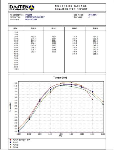

anyway here's the latest dyno, RUN 1 is the last run that i posted, RUN 2 is today's run, managed to hit 270.3 HP at 6k rpm, and RUN 2 Torque is at 344.3 Nm at 4.5K, after RUN 2 however, my clutch is slipping already thus affected RUN 3 and RUN 4 figures....

normality,
sorry lerh, ZTH limited the file size, so i gotta downsize the pics which affects the quality....

hi kennethfong,
your power seems very impressive. however, each dyno machine will have different readouts depending on the calibration & the way to obtain readings.
i.e letting go the throttle w/o depressing the clutch on the rollers will have different reading on the dyno.
IMHO, northern garage dyno reading is on the high side. i got feedback from a stock gsr with safc can reach 250hp on wheels which i don't think is possible.
perhaps you can try out on a different dyno machine to compare. good luck with your tuning. :)
ftzone,
thanks i think know the fella GSR with SAFC, he's someone from the forum, few months ago he got 220 HP, his GSR is a manual and the dyno is measured for power on engine and not on wheel that's for manual, thus for manuals the dyno is set to measure on engine however for auto it's set to measure on wheel....
the purpose i use this dyno is to see how much improvement i got from my first dyno at 195, second at 211, then after newly serviced turbo for the third time to see how much improvement i've achieved, ur right however in saying dun trust the figures which i understand coz different machine will have different figures, however this will not stop us from benchmarking the accuracy?.....

bro kenneth,
i dun get it. why must the manual get reading my engine but not on wheel? I tot mostly dyno all showed power on wheel instead on engine?
normality78,
i expect someone will sure ask hehe, i've asked him myself when the dyno first arrived, it's the calculation software they use, the machine is from dastek dynamometer, preferably they'll use on engine due to some variables such as differring gear ratios, wheel size, sometimes 2 wheel / 4 wheel gearbox may affect the outcome, further than that someone needs to ask the shop owner dee hehe.... so bottomline is for accuracy, he'll use fourth gear on engine for manual, and on wheel for auto coz auto it's hard to get gear ratio closest to one (for manual normally fourth gear is 0.97)....
on engine dyno however, after u get the WOT at more than 6.5k RPM, and as when u've release the throttle, u need to wait until the wheel slows down and that's when u can c the graph climbing back to its original position on the screen, that's how the machine works to calculate on engine power.....in my opinion these are all debatable subject topic, coz if u look at it, how accurate could it be for a calculation backwards to the engine in which the reading is taken on wheel from the dyno rollers, hehe, so i that's y i said it's good if we get the benchmark from various cars so then we know....

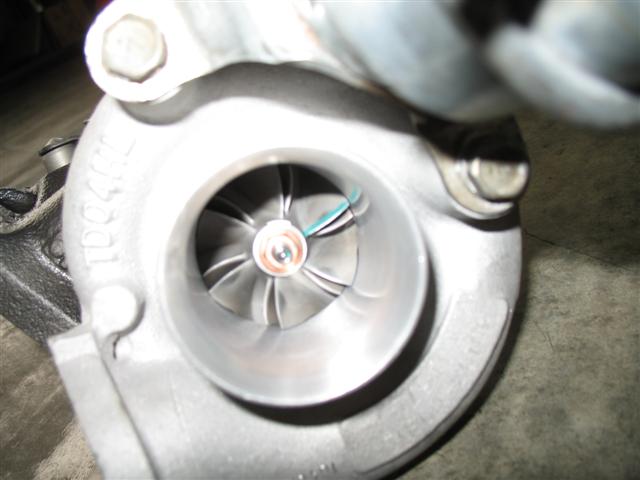

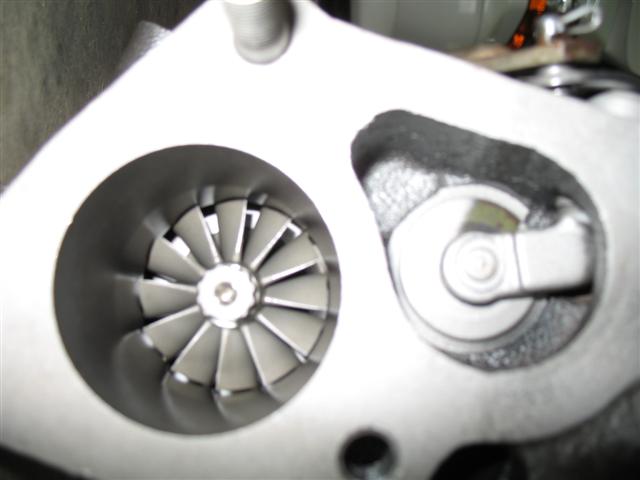

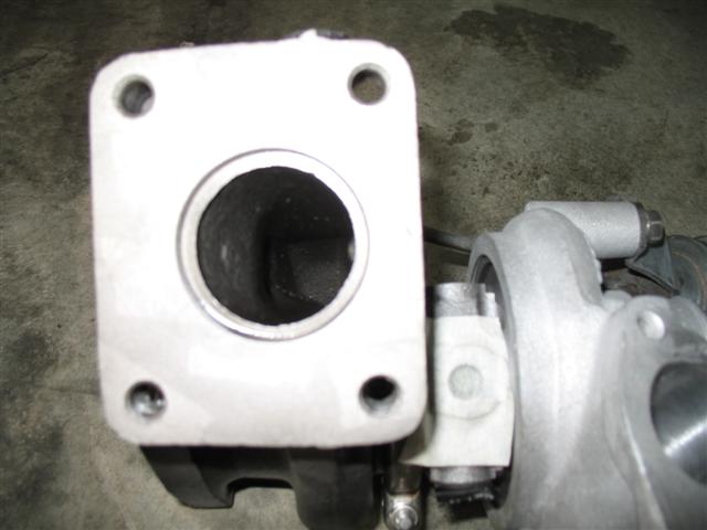

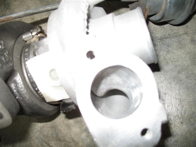

please see below for the fantastic job done by Turbo One....
SDF,
not promoting lerh, just telling the fact from my satisfaction.....

How much does you pay....I think it hurts???
PS:TDO4HL is from VR4? Pls advice?
skyline,
this td04hl aar, haha.... eerh how do i begin, at first i bought my gsr, without knowing the turbo is completely jammed.... since the mech guarantees me for everything in good working condition, so he changed for me another TD04L, which is puffing loads of white smoke at the 2nd day of install, then change again FOC for the third time, then dunno from where he got this TD04HL.... dunno whether it's from VR4 or not, using it until recently i feel i need some upgrades then Turbo One....
