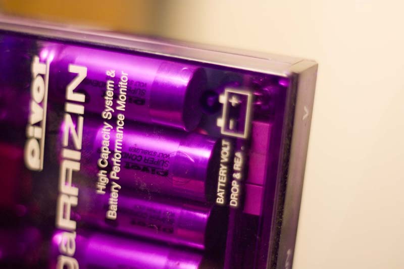

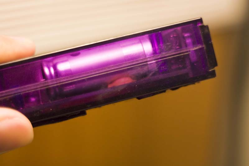

I had a unit of Pivot Mega Raizin VS installed which I bought for RM370 in September 2009.
This is what happened when it failed.
I was driving to somewhere this morning with my family. I notice my ICE suddenly lost all power and subsequently every other electronics in the car, gear position, indicator lights and all. Weird thing was the battery indicator was not lighted as when battery or alternator fails. I could still drive the car for 2 km to drop off my family at destination. After a further short drive home the engine started to stall. I prayed to God asked him do not let my car die in the middle of the road but it finally stuck in front of a traffic light no matter what. No restart is possible.:bawling::bawling::bawling:
I got off the car and waved :wavey:to the traffic behind to say sorry and opened the front hood as everyone would do to sneak around like a pro but I really had no clue. I thought it was the battery playing me up. I didn't know whether I was purely lucky or although God didn't follow my prayer but sent an angel to the rescue. Suddenly a R32 pulled over in front of me. It was my mech friend, hahaa. He did look good like an angel to me now:angel:. He spotted me and stopped to help. After jump-started and headed to his workshop for some simple diagnosis, he ascertained the faulty VS drained all the electrical current.
Can you guys spot the problems in the photos?

my best guess is the capacitor leaked... take a whiff and smell the raizin...got those "electronics-burnt" smell or not...?? lucky it didn't fry the ECU :s:...
Can't see much from your photos. Need to open it up and see the inside and test with a multimeter.
Also, MegaRaizin for RM360 is dirt cheap. Ori ka?
u bought from kakimotor ah bro?
I bought from zhapalang.com
There are at least 3-4 capacitors burst. Look at those orange patches of shit leaked?
They claimed it is original. I remember they had a guide to help spot the original from the imitation. I found that to be original though.:dontknow:
that orange thing is leaking capitor fluid ka? I thought that was glue holding the cap. Anyway, it's a shame the thing burst. But like all electronic components, unless it's military grade, they all have lifespans la.

I am not sure whether the orange thing is really the cap fluid, beside this I found nothing suspicious visually. But one thing for sure the vs sucked all the current away from my Perdana V6. I think is standard voltage because no sub no heavy ICE.

I opened the vs casing to check just now, the orange patches are hard and look like some kinds of glue to secure the position of the capacitors. Other things just look fine.
