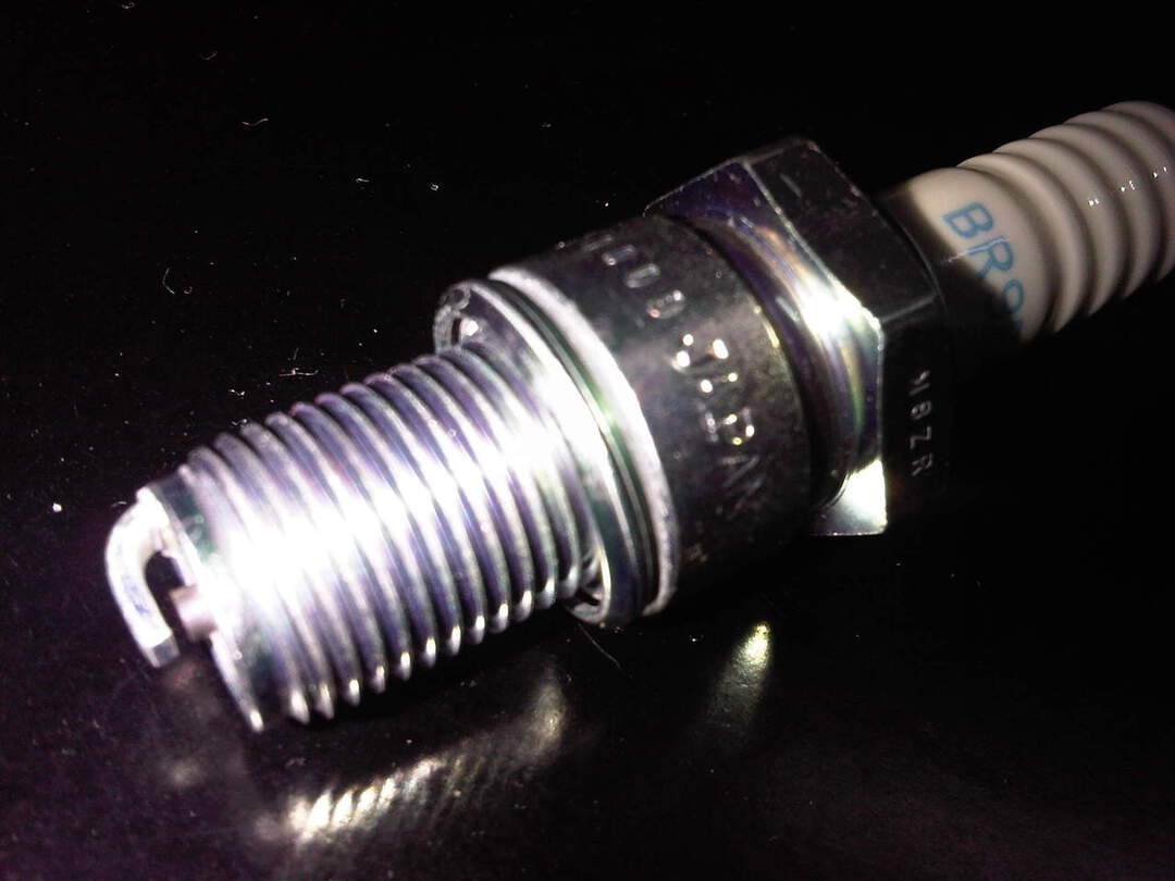

Change spark plug NGK BR9E good for Ethanol and over 45psi of boost

Im running a Natural Aspirated 1.8 mivec motor, does this NGK BR9E spark plug compatible?
If not, what other spark plugs are advisable.
No..BP big size use for EVO,VR4 and OLD SOHC engine.
For New Engine have to BKR7 or BKR8

There is a recomend plug BR8 or BR9(stock motor BR7)
I was sold for RM20 each
Box is 10pc RM200 to your door step
