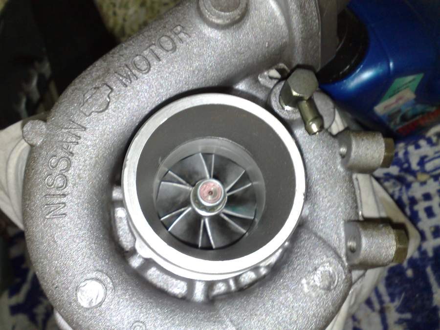

i have a nissan RB25 turbo, its a garrett t3 for my mazda B6T engine.
i didnt install it yet, do i need to change the injector and fuel pump for it,
and what is the proper boost level that is safe for my car,
and probably how much power will it produce after installing it?

below than 1.0 bar its consider safe....depend on u setup and ur mechanic experience and last but not least ur LUCKS!....caw!!!
