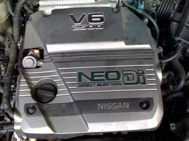

Dear all, i am driving a A33 3.0 cefiro and the engine is gone recently due to gasket and engine heads problems. So I am now in great dilemma whether to change the heads alone (new) or the entire engine to VQ25 NEO. The price for both solutions are same.
Basically my engine is still ok with total mileague 113k KM, and the half cut of NEO looks cool but the mileague does not seem ok to me ---> 180K KM. Of course it would save a lot for me in road tax if i convert to 2.5. However, I have never seen this model before so would ask for your opinions on this engine as well as which solutions would you choose if you were me. Thanks a lot!

I'd go for the NEO 2.5. First of all you get almost the same horses with your VQ30 (around 210hp!) but paying cheaper road tax. Secondly , its not recommended to do a head job or replacing gasket for the VQs. Even if some mech offer you to do it, I'm sure there will be lots of hiccups thereafter. (ie; noisy timing chains, lose of power, noisy hydraulic lifters,rough idling, overheating,etc). These information were gathered from previous fatty owners who opted for head/gasket replacement over engine swap.
However, if you opt for engine swap make sure you change everything from the neo 2.5 halfcut from ECU, wiring harness, engine , gearbox(ecu) , drive shaft, front suspension, disc brakes, abs, sensors, etc. (er..almost, you can return the body and frame to the chop shop).Otherwise you would face some running issues later on.
