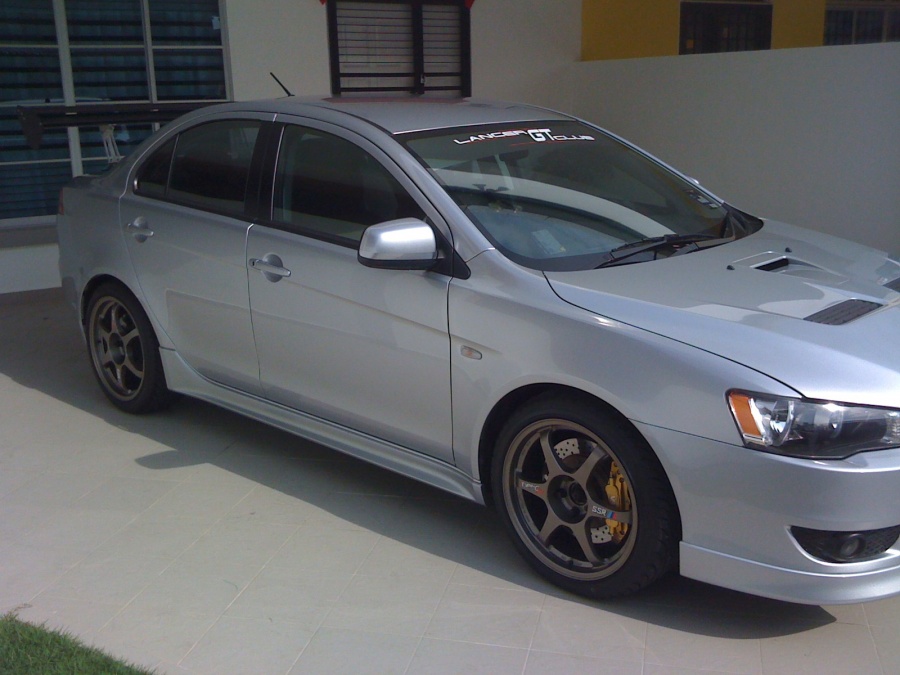

i'm using it now. i wouldnt say very good. coz no matter how, it cant beat the big boys like endless, alcon etc. but to say that its lousy, it cant be.
although i not driving an evo. but i can say that it is good enuf for daily drive or occasionally track use.
i using big 6 pot with 2 pc 330mm drilled rotor.
but u on evo, go for those big name ba.
for myself,i cant afford la.

Bro,
Thx for sharing! Nice car u hv there!
Me too, at the moment just cant affort a brand new branded 6 potters such as AP, Endless n etc... LoLzzzzzzzzzz...
Will upgrade it step by step till i got enough budget la... :slug:
