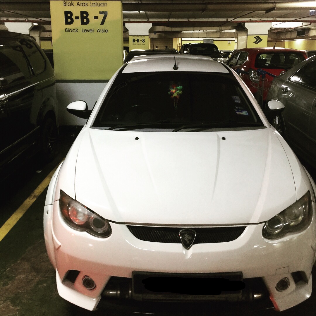

My first fun car, which has been serving me faithfully for about 2 years now. :love:

Nice, Intercooler slightly hidden......:biggrin:
Small intercooler hahah! If it's painted black, it will be even more hidden but I like the current look.
Campro with bolt on turbo or Mitsubishi 4G93T?
Ya it's a bolt-on. Was contemplating 4G93t but settled for bolt-on eventually.

Yes it is fun on its own handling wise. I've upgraded the suspension to BC Racing adjustable, 6k front 4k rear, so far I think it's the best balance between handling performance and comfort.
its a bolt on..
How did you tell whether it's bolt on or 4G93t? Size of intercooler? :idea:

Interesting project. Is this bolt on stable and roughly how much power you are making after this bolt on?
Yep pretty stable. I will say the whole setup must be done correctly (for instance piping quality, materials used for connecting hoses and clips), if not some reliability issue will emerge sooner or later.
I'm currently using Haltech Sprint 500 as the main ECU, previously was using a UnichipQ. Internals are all upgraded to CFE semi-forged, with 1.5mm metal gasket.
Let's just say the power is about double of the original Neo CPS, around 230whp @1 bar. Good enough for a small car like this!
No traction issues? I'd assume you'd break traction at every gear if you floor it.

Bolt on with stock internals boost to 1 bar?....fuh!
