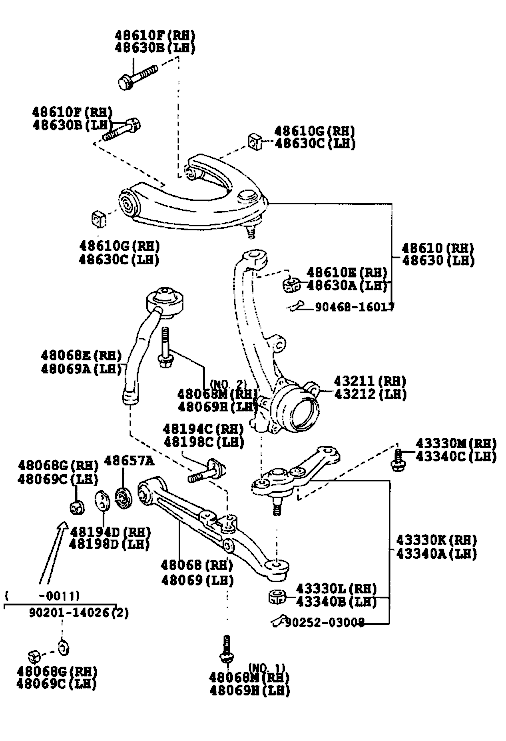

bro, pls refer to the diagram, and from my experience...u need need to replace the who;e unit unless u r able to source aftermarket bushing for the replacement.....cheers!!

the only option left so far is TRD. the name and part no. for this bush is Front lower arm bush No.2 48655-SE100.
