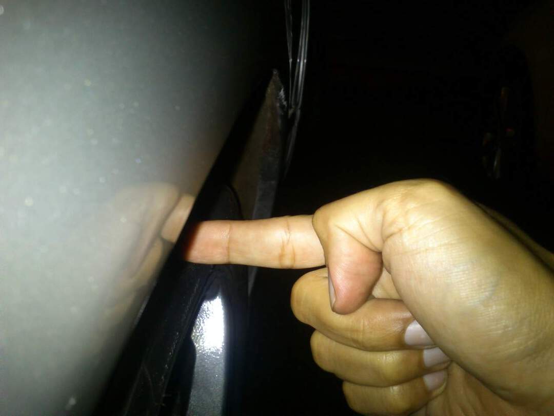

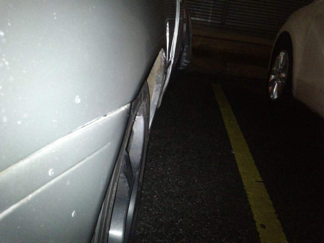

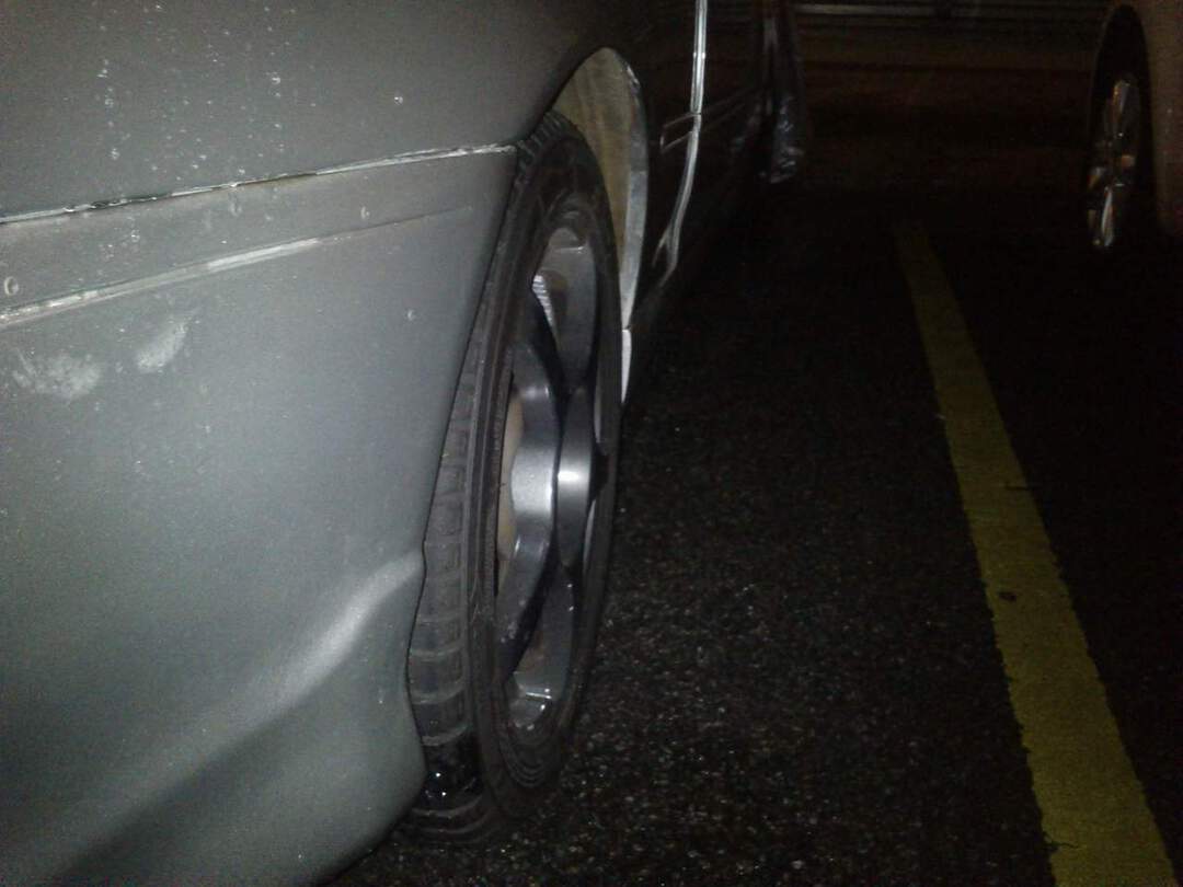

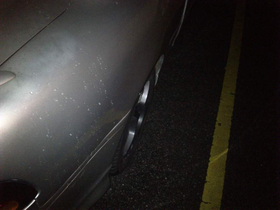

Not crazy offset la.. My rear tyres sits about 1 inch inside d body n it doesn't look nice..
I'll take some photos 2morrow 4u2c :wink:
sorry.. a bit late to put pics..
better late than never, right? :biggrin:
pics below
