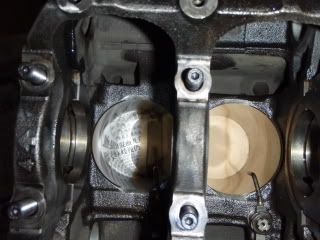

8 ... where the crank angle hits ...
see the attached pic ... the left one is the one where slight grinding was done. The right yet to be grind on the upper side. The bottom of the pic for the right pic already grind ... anyway your mechanic will know becos whe u tighten down the main bearing cap & turn the crank by hand, u will see where touching slightly ....

PabloIceman, cannnot see the pic clearly... got more pics arh ?
i think i can see the upper side grind. but no idea for the bottom part ...

Don't have clearer pic laa but if u can see the grind, it's the same for all 8 sides lor ... This one my 'friend Doggiestyler' engine one .... :flute::flute:'He' already finish installing ....test already at Sepang .... :rofl:
