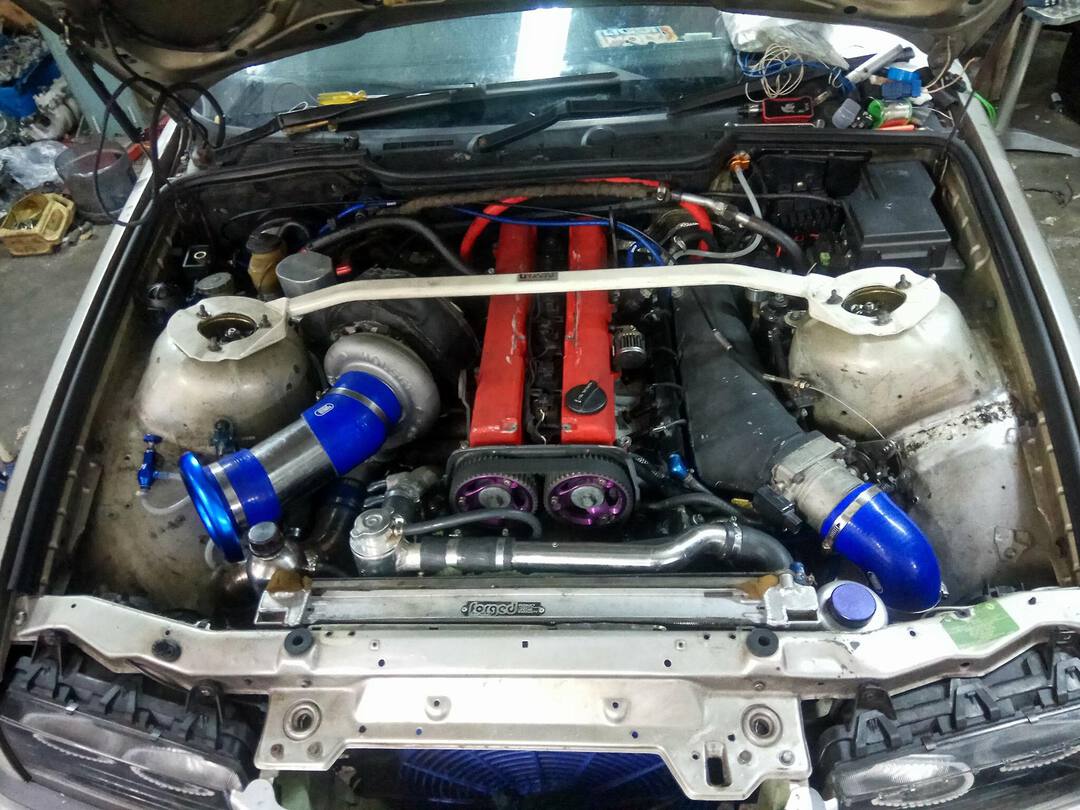

Recent updates :
- Car broke down at home. Starter was dead. Voltage detected at the started was less than 7v.
- Oil leaked out from the relocation of the cooler. Braided hoses were leaking.
- Found a few melted relays. Earlier 2 high speed fans were wired to one relay, so yeah melted.
So now the car is with a good mechanic friend. He cleared up all my wires so now my engine bay is super clean. Almost wireless! The birds nest of wires in the passenger foot well as been tidied and ECU relocated to inside the car instead of engine bay (for cooling purposes). So now he's working on the major oil leak. Hopefully after this the car will be ready for the road.
