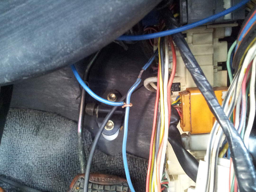

Then I realized the fuel pump was not working because I'm familiar with the "hissing" sound it usually made. Long story short, I wiggled some random wires behind the center console then suddenly I can hear the fuel pump. Then I can start the car.
So I took off the center console to reveal the wiring and ECU. I noticed a circuit opening relay which supposedly is the fuel pump relay from what I read online. Do you guys know how it is supposed to function? I held it in my hand but I didn't feel the "click" when the key was at ACC, ON or Start but the car was started. Even better, I took it off and the car still starts. Probably the mech didn't even wire it at all?
Also, now that I am paying a special attention to the fuel pump, I noticed the pump is running even when the key is at ACC. Not right, right?

A little update.
I have yet to send the car to a bengkel. Still trying to debug (for the lack of better term) the problem. After what I found today, I'm kinda glad I did this.
I found the connection that provides power to the fuel pump directly when the key is at ACC. Picture attached. Looking at the state of the splicing I am 90% certain this is the culprit of the intermittent fuel pump dying issue. The blue wire on the left has 12v when the key is at ACC. The exposed blue-black fuel pump wire has oxidized and I may need to replace the whole wire. Sometimes the level of incompetency shown in the workmanship is just unreal.
Next step, settle this blue-black wire thing. Then need to figure out how to wire the FP relay (or maybe bring to a mech).
I have also heard people say the FP relay is not that important. If I were to follow this path, what should I do? Replace the blue-black wire and add a splicing with the ACC blue wire using a better connector? Still sounds not right.
