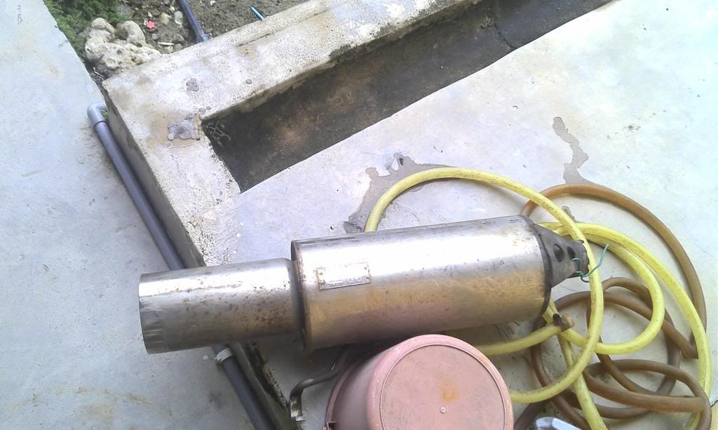

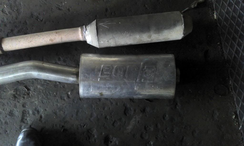

from front till fuel tank 2.5", from there 3" to muffler .
