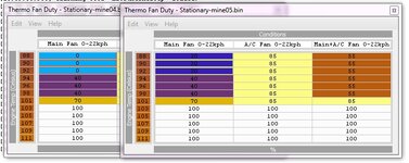

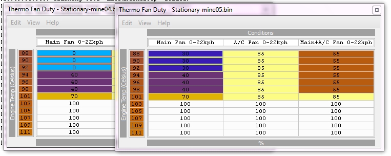

tested. it is controlled by ecu and can be changed.
test was done on stationary condition, warmed up the engine until around 88c (which is the lowest threshold on the ecu for the fan settings).
my stock fan setting in the ecu only will run the fan once the temp hit 94c, which was correct, neither the fan were moving around 88c.
then i changed the settings to run the fan once the temp hit 88c, and confirmed; the fans were moving.

If only you can remap for me ... *sigh* thanks for the confirmation bro.

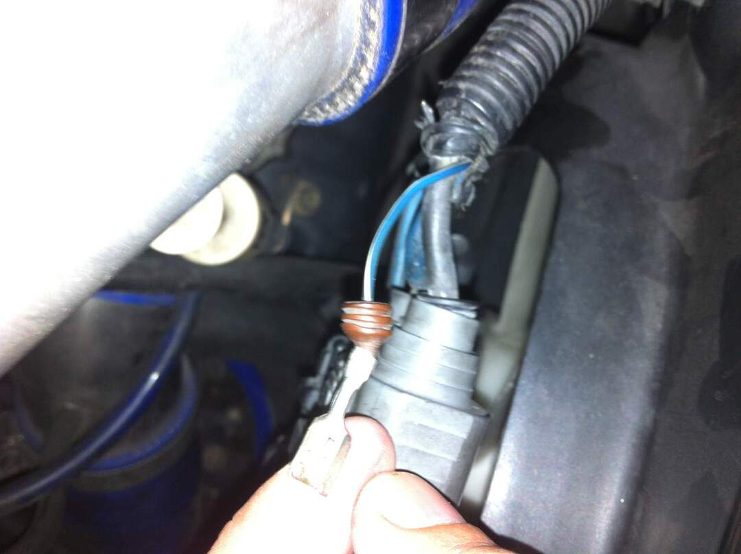

i didn't remap it ~ cos after 2 time i change the fan control ~ i give it up and unplug the Earth cable of the Fan remote . now Full Blast all the way .usual water temp 70 - 90 . been using it a wile with out fail . once i read from a forum , some one unplug it and run 5 years without failing .

Fan motor will die slowly . Mine already use for few years. I can't show you the pic now . But as I recall its the brown color wire . It only will eat up you electricity when you only push key to step 2 ignition key with out starting the car . In Malaysia it's better you let the fan go full throttle cos of our weather . Plus 2nd hand motor only cost you rm30 or less each .....

here's the blue white wire , you need to unplug to let it run freely
