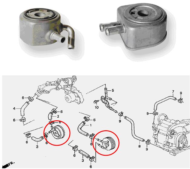

guys, i'm in dilemma.... i've bought an ATF cooler and gone to my mechanics to install....
upon checking, he said that my GB already have ATF cooler... i was surprise... it was an oil-to-water cooler (like the attach pic).... my question?
1.) water-to-oil cooler better than air-to-oil cooler?
2.) or install both (in series)?
3.) if install both, which ones first?

U can install both in series, but not sure which one come first.
I have installed the ATF cooler in my Toyota Wish & it is in series with the water to oil cooler.
thanks... any significant changes in gear change?
Gear changes is the same. This ATF cooler is only as a safeguard system to prevent the ATF from overheating in situation like stop go traffic & going up steep hill like Genting.
Some of the Toyota Wish Club member with Informeter have stated that Hayden ATF cooler can keep the ATF cooler by 10C compared to without in extreme driving condition like going up Genting.
