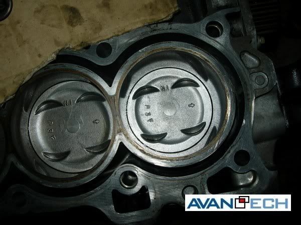

if using oversize piston yes... it'll bcome thin..
this how the 2L cylinder thickness look...

Nice Pic....Thats a P3F Piston of the B20B - standard bore,13020 is +.25mm. Low Compression Flat Piston.
