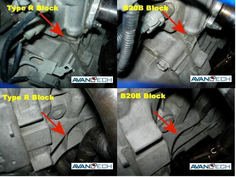

ok guys... here we go... some pics to differentiate between type r block n b20b block...
good pics....now those JPJ and police can easily check out the engine number been punched or not....die laa we all b20 punya.........
why? B20B can be JPJ approved mah.. got a few done before.
It's your fault you want to 'disguise' your B20 as something else so you can tapau B16A fellas.. :P
aiyaaa... its very easy to identify the b20b block...
btw, i did send this pic to jpj last 2 years ago.... :P
avantech is working on a partnership with JPJ all this time :regular_smile:
Just noticed that the B16B block and head is similar to B16A..It's oso like the B16A when I went and check.. (O_o)
haha no laa...
actually its good only for education purpose...
we work closely with the MOE.. to educate the secondary students to learn somthing about honda engine... haha

hattech-v said:
block n head similar which part?
Those two arrows pointing at those parts.. B16A is also like that..
btw, i did send this pic to jpj last 2 years ago.... :P[/QUO
grrrrrrrrrr:baring_teeth: ............eheheheh :P
b20 tapau b16a????beware bro......:P
