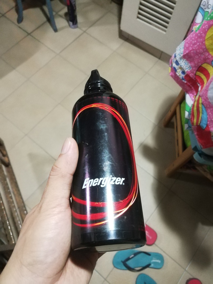

[DIY] Oil catch tank
Gonna turn this thing into oil catch can lol.
Just need to measure the PCV valvle size etc.

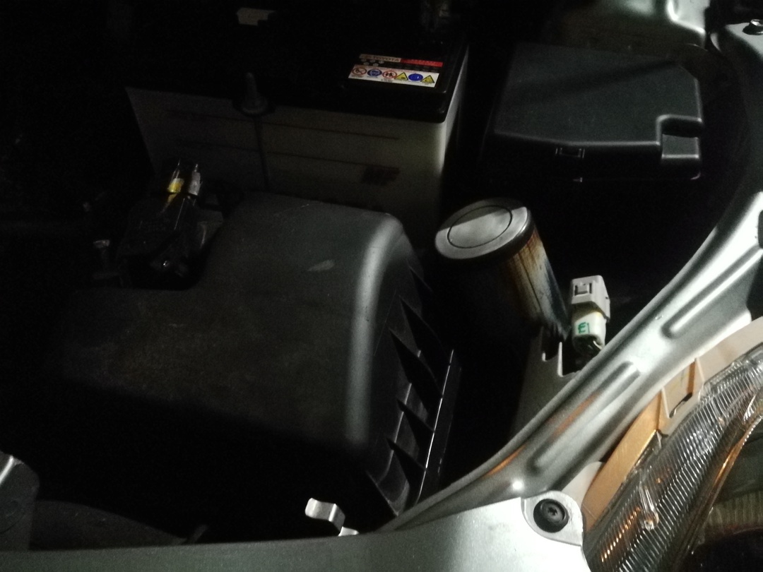

I dunno.. maybe I connected mine wrongly or the filter was directional and I fitted it wrongly
Even terbalik, won't get crushed. Maybe because of heat it melted but then in my turbo VR also very hot still survived.......lol

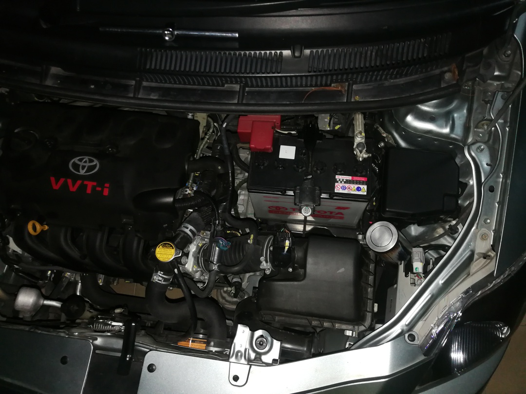

Oh ya, guys, if I placed my oil catch can here shouldn't be a problem right ?
Away from engine, between battery, air box and fuse box

your crankcase runs at positive pressure, not a vacuum, its why you can blow crankshaft seals if the breather is blocked, the reason is some compression escapes past the rings, on the fiat engines at high rpm (7-8k rpm) the pressure is such that it can stop the oil draining back from the valve cover, causing filling of the valve cover, oil starvation to the cam and lowering the oil level in the sump, so abarth had a crankcase breather with oil arrester AND a valve cover breather with pipes going above the engine, then down to a catch tank. Now I know your car is not a fiat abarth, but i use this it illustrate how all internal combustion engines run at positive crankcase pressure not negative (vacuum), My plastic oil tank is also shrunken on my Coupe, its due to exhaust heat and the hot oil fumes melting the plastic, these bottles shrink when heated, try it, throw a water bottle on a fire.

Heat from oil fumes shrunk my plastic petrol filter OCT. Makes sense but I didn't think a K3VE would make that much heat.
