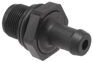

Hi bro zul. Actually what I have discovered are differ from yours.
PCV valve will always open when there is vacuum from intake manifold, not open only if got high pressure.
I've confirm this, when I unplug PCV valve from cam cover (with vacuum hose attached and engine running) I can heard whistling sound came from PCV valve. Which mean PCV valve operate without any pressure.
Please correct if I'm wrong
I don't know exactly how it works. Mayb its a 1way valve
Anyhow, i think caarzee should check that valve 1st. Mayb its not working
hi D7zul,

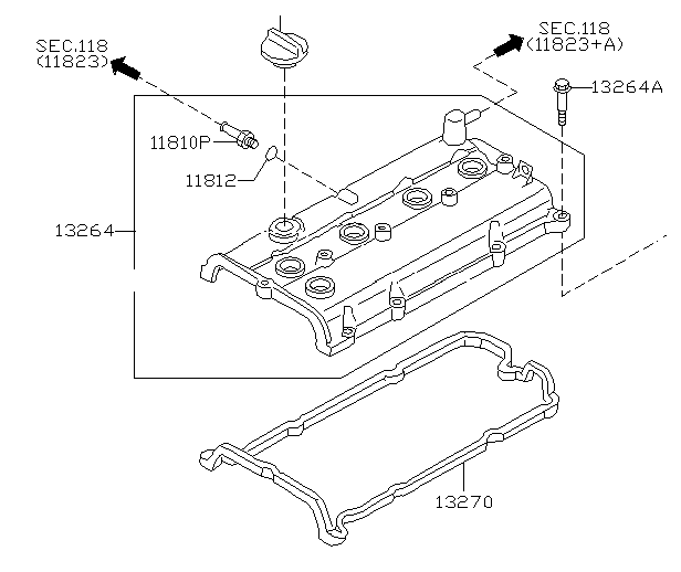

Here's the layout and the sample image of the PCV. It has a valve but I don't know if it operates when there is high pressure inside the crankcase or whenever there's a vacuum pull from the intake manifold or both. Engine is Nissan QR20DE for 2.0cc or QR25DE for 2.5cc. Car models - XTrail and Sentra year 2004-2007.
Here are some self test, provided the valve is on the hose.
http://www.dummies.com/how-to/content/how-to-check-and-clean-the-pcv-valve.html
http://www.oreillyauto.com/site/app/newsfeed/detail?article=800567427
Thanks.
