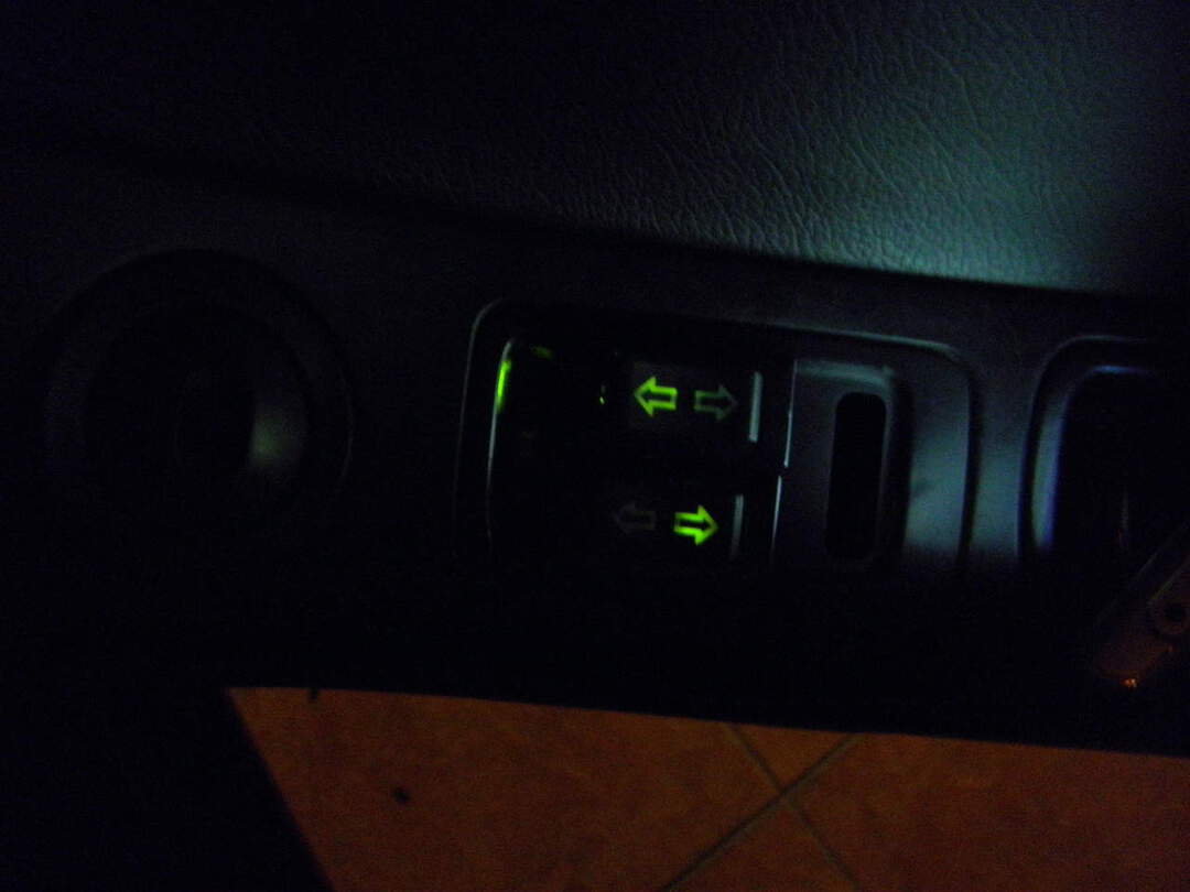

due to shortage of parts,, started this project for modifying master power window switch,, due to poor response towards the previous posting ,, i would make long story short,, connect the wire (easy la plus minors electric points bla bla) then make bigger hole or reduce size of switch then voala,, ready..
if you think it is easy it is because you havent tried it hands on till whole biji(assembly) is produced.. if you need more info could pm me.. welcomed.
