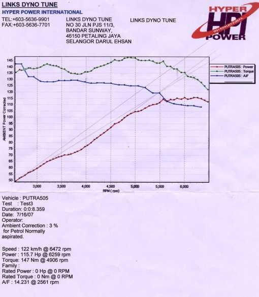

Around 260WHP
here the spec for V6TT
1. engine standard gaban + mivec gearbox
2. injector (original V6TT)
3. 6A12-NA ecu + e-manage (blue) + E01
4. wastegate cap ayam + HKS SSQV BOV
5. Hot Inazma (complete set)
6. Spark Plugs (OHS - or sumthing like that)
7. NGK cable plug
8. Intercooler (custom - size of evo)
9. NOS
10. Boost at 1.2 bar (the run profile as at attachment - with and without NOS)
the value for NOS run is higher (370) at first but due to nearly empty of the gas, the value gone down and the higher value (370) run had been overwrite...
NOS had refilled and going to perform another dyno (trying to achieve 400)...
kind enough to give some tips on how to achieve it.
