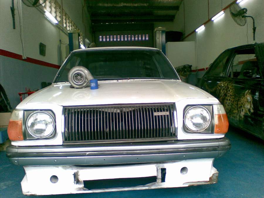

Let me start and you all continue
This is 3rd Gear Baby Born
Mazda 323 Clasic year 70+
Engine Mazda B8 still under Rebuild
Manual Trans Waitting Gear ratio from G-Force USA
Custom Jeam Barry Clucth Single plate Carbon 1000hp
4.7 real xcel Full Lock LSD
More Info we update later

Customer 3rd Gear Satria 4G63 Turbo Drag Car.
Spec
1.4G63T Block
2.1G Head Set Polish
3.Stage 1 3rd Gear Regrind Cams
4.86mm over size EVO pistons
5.Hardened EVO Rods
6.Stock EVO Crank
7.Bosch Coils
8.Stock EVO Throttle Body
9.Stock Manual Trans
10.Xtreme KEVLAR Clucth Set
11.Cromoly Flywheel
13.1000cc Injectors
14.Bosch 980 Fuel Pump
15.Microtech LT10s +x4 Box
16.Dry Ice Box cooling for more Boost.
17.Red Line Racing oil Lube
18.Red Line Heavy Duty Manual Trans
19.Custom 3rd Gear T400 Turbo from Speed Spin Malaysia
This is starting for 1st stage 4G63 turbo project.
Anyting we update u later.
