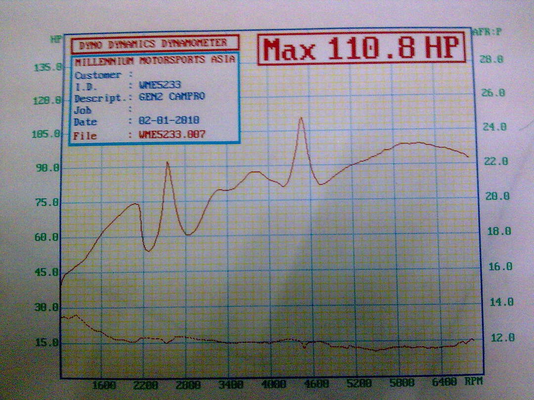

wth happen to your powerband ? :hmmmm: irregullar power peaks n drops ?

the 3.2bar is set based on the chart....as u can see the af ratio is at +-12....the setting is quite rich below 2000rpm but become more optimum when reach above 4000rpm.in my opinion if ur set the fpr to high reading for example 4.0bar above the possibilities to going lean at high rpm is high.hence the gasket will kabooommmm..moreover, my sifu said the af line will become more constant line when upgrade to management....any others who have the af ratio graft pls...share with me...thanks

looking at the graph, d engine produces around 96hp, impressive jugek. its a shame dat d campro is a fuel guzzler, or else ive gotten meself a waja campro dah
