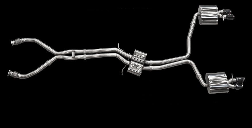

Is it possible to make FWD v6 dual exhaust piping after exhaust manifold to rear axle as RWD V6?
any Pros n Cons?

Depends on how much power your engine is making. If you're engine is not powerful enough, it can result in loss of low-mid range torque even though top end power is better.
So what engine do you have?

just a standard stock open port 6A12 NA.
I'm just doing some research from otai2 because in theoretical I learned only engine with dual banks can use the dual piping system as they said in theory lesson "The faster and more efficiently the cylinders are cleared, the faster the cycle can start all over again"

If stock 6a12 n/a no need to waste on that setup. Customize a good stainless steel extractor, 2.0" - 2.5" piping (depends on transmission) a good quality center box and muffler. Got budget summore get e-manage piggyback. With right setup, an auto tranny also can habis meter on top speed. :biggrin::biggrin::biggrin:

Is there any differences between auto and manual tranny exhaust setup?

yes. auto tranny needs a smaller piping size, midbox and s-flow muffler for back pressure. manual is more to less restrictive system =)
if 6a13tt (m) engine use 3" piping from front to rear coupled with aftermarket exhaust.
