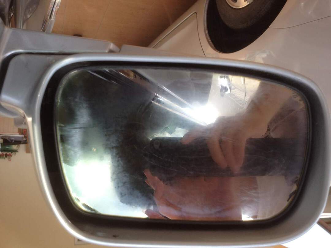

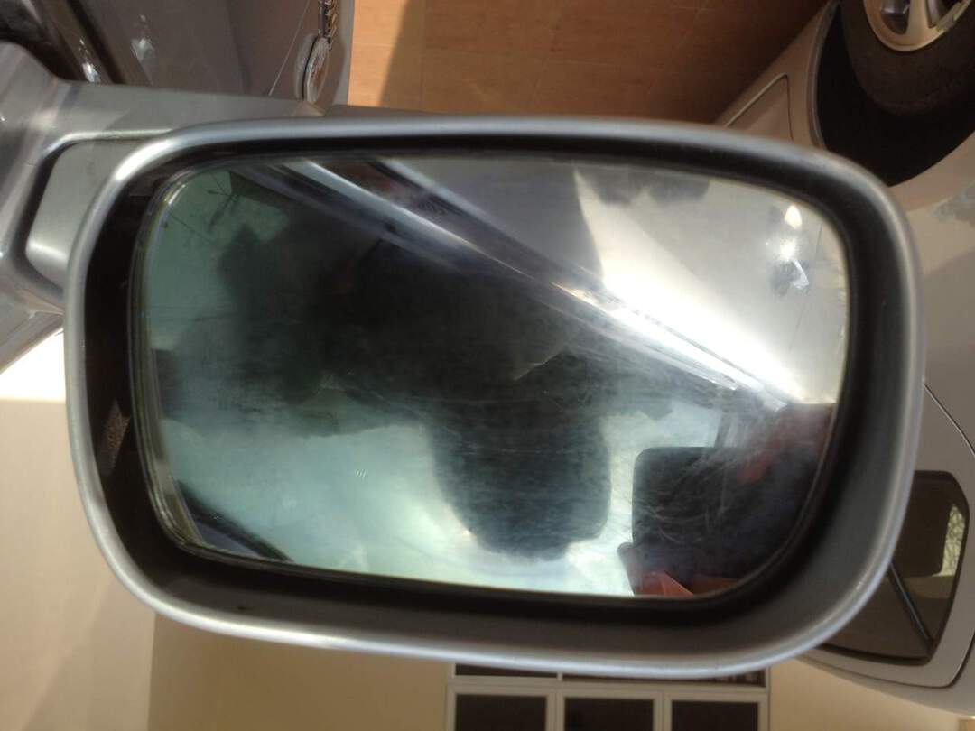

Hi all Sifu ... Few days ago I tried to clean water stains on my side view mirror using the water stain remover. Then after that the side mirror started become blurry and there is a rough matte surface on it. I tried all sorts of way I can though of to get rid of it but no luck. :bawling: Hope all sifu's can provide any ways or suggestions to get this fix. Any suggestions and feedback is greatly appreciated ...
Post a pic of the product you use. If the mirror is scratched then you might need to repair/change. If it is the product stain that is on the mirror surface, you can try turpentine. But to be safe, please post a pic for the sifu here to comment and advise...
I used some sort of rain stain remover. Its written "Glass, Sport Rim & Copper Stain Remover" on the label and then later only i get to know its acidic and cannot be used on side mirrors. Below are attachments of the current state of my side mirror.

Looks like it has been scratched...should be some polisher it is. If you can't wipe it off with a cloth, it might be already damaged the mirrors. If you have turpentine, can try to use a little bit on it and see how it goes...hope it is just the stain and not damaged mirros. Good luck.
Bro cvkit17, thanks for the advice. I am refering to the whitish blurry stain as before using the product, the scratches is already there. I guess its the product stain. Now there is a layer of matte, blurry white haze on it.:bawling: May I know is turpentine same with thinner ?

The mirror isn't too expensive to swap out mah. Those cleaners are meant for glass, your side mirrors are plastic
This statement is correct.
From the looks of it, it seems like a Myvi mirror *do correct me if I am wrong*
Rain stain removers, rainX dan the likes of it will stain the side mirror as it is plastic.
This is from a person whom has done it. Side mirror, clean it often so there is no rain mark on it.
Glass polisher products are ok. Sometimes, the mirror is damaged simply because the owner "over-power" polishing the glass, or the cloth used is unsuitably rough.
Ah..the sifus have spoken. Sorry to know that nth can be done.
Not to say that it cannot be saved. But sometimes its just better to replace it since the mirror is already in such a bad shape.
TS, if you want to try, try polishing. DIY style, u can try using toothpaste and a microfiber cloth. Or if you have any paint polish/compound, can try that as well.
What has happened is that the surface has been tainted. So removing the top layer "might" help. But seriously, i think changing the mirror saves more time and effort. Just sharing my opinion.

:bawling:It is the side mirror of a Toyota Camry. I am broke at the moment as the side mirror is quite expensive for me.
Thank you so much for the suggestion bro. Will really try that. Can the normal rubbing compound we use for the car paint work? Is that what you mean? And what happened to your side mirror after that?
I had the same happen to me on my Wira, Putra and Inspira.
Wira:
- Tainted by rain stain remover
- Solved by replacing the mirror (RM 8)
Putra
- Tainted by RainX
Inspira
- Tainted by RainX
- Solved by claiming warranty from Proton (it was still under warranty so why not).
Give the toothpaste method a try if budget does not permit. Just make sure you use a clean cloth to avoid more scratches. And also do take care not to scratch the back of the mirror else you can say bye bye to the mirror.
