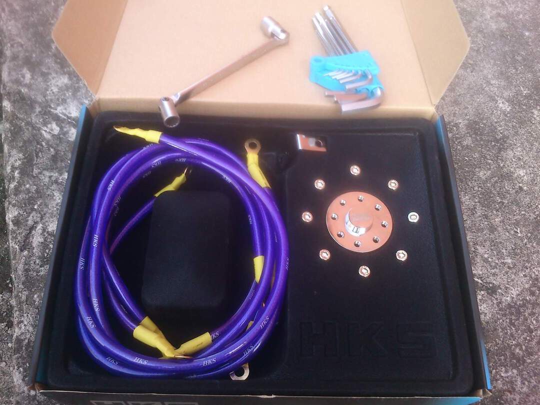

Things u need :
attachment.php
1. The Grounding Cable Kit (mine is HKS)
2. Spannar
3. Allen Key

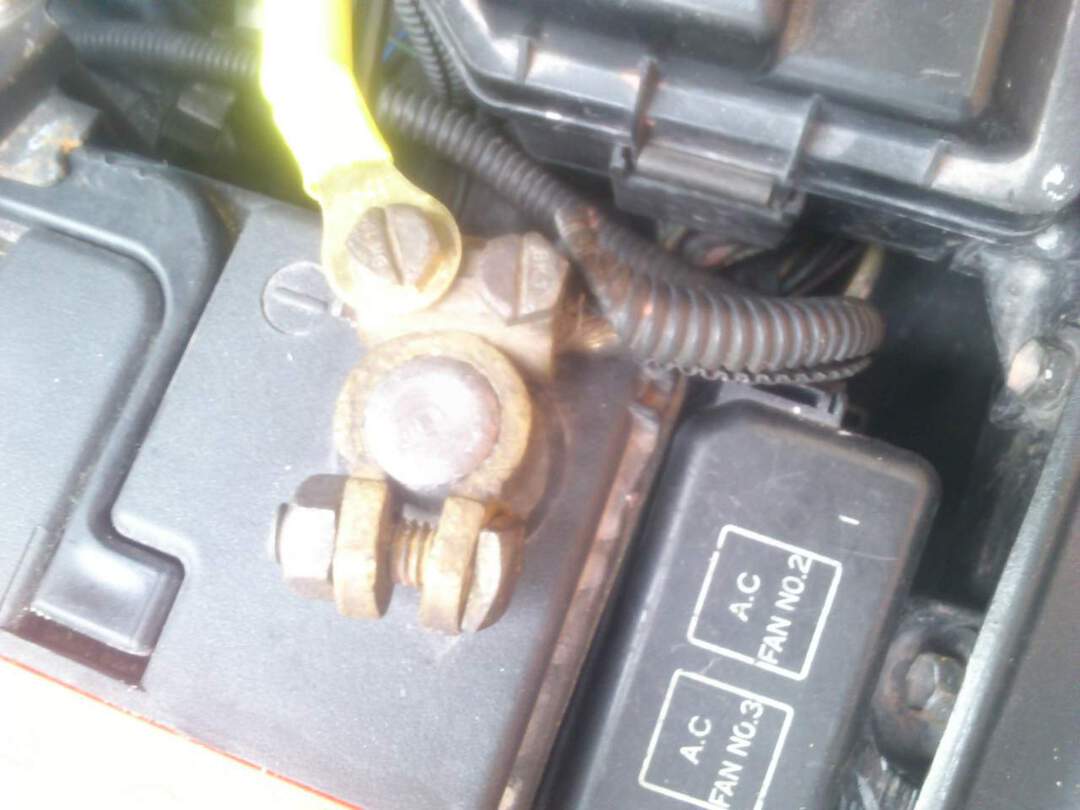

Disconnect your battery
I don't think this is necessary but BETTER BE SAFE THAN SORRY :wink:

2nd Step

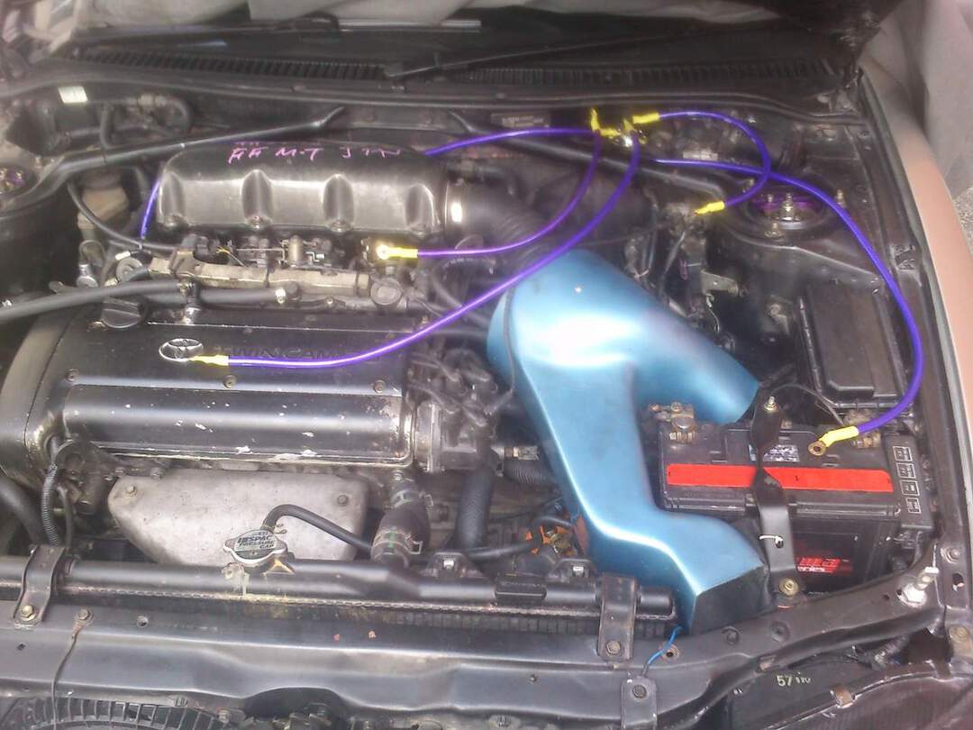

Lay down the cables on top of ur engine so u can get a perfect place to put the round connector thingy :biggrin:
Please make sure your cable can reach all these things :
1. Negative terminal at ur battery
2. Alternator
3. Firewall
4. Distributor
5. Coil
6. Injector
attachment.php
3rd Step

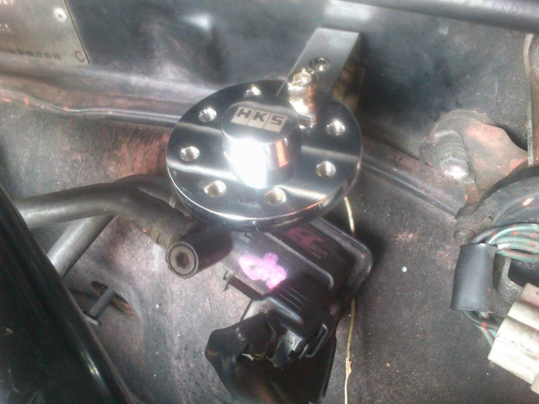

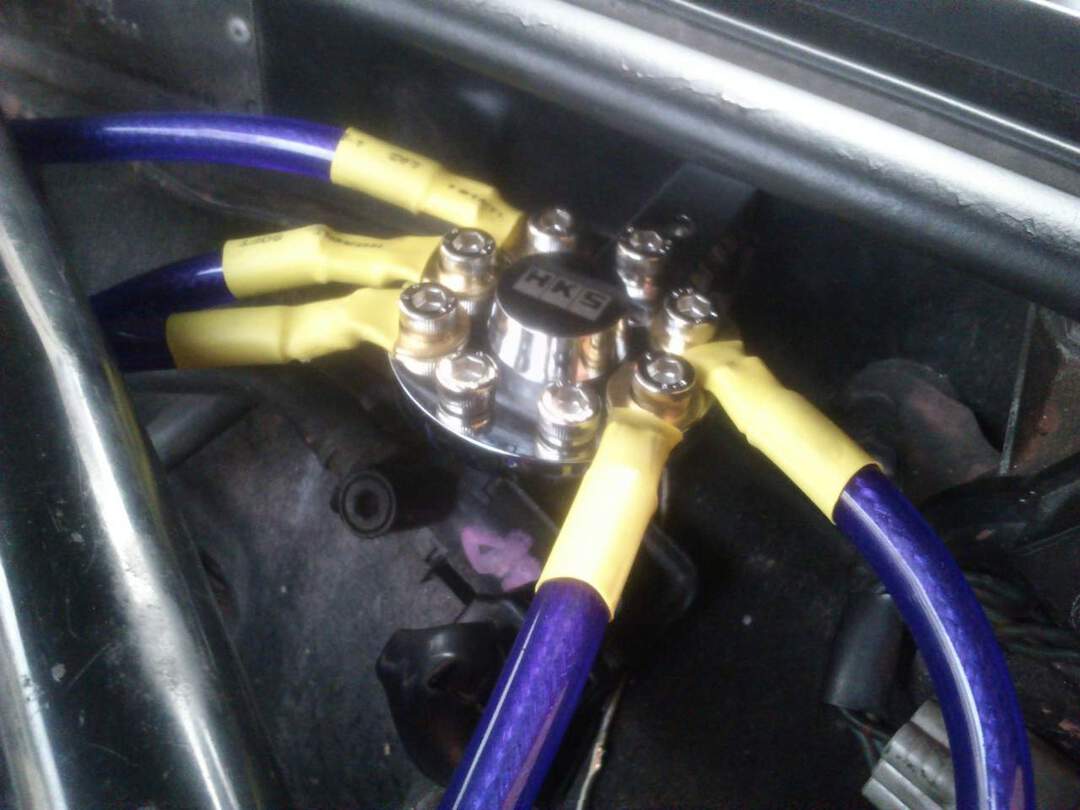

Mount your round connector thingy (i really need to know what's the name :biggrin:)
attachment.php
4th Step

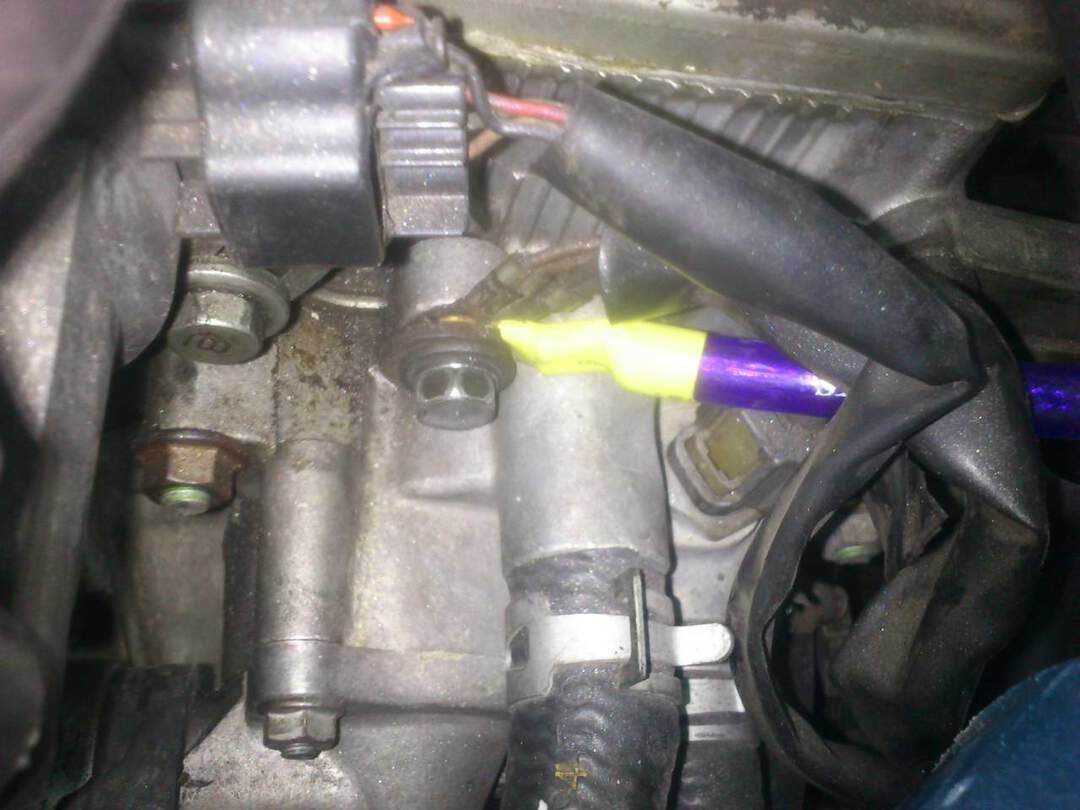

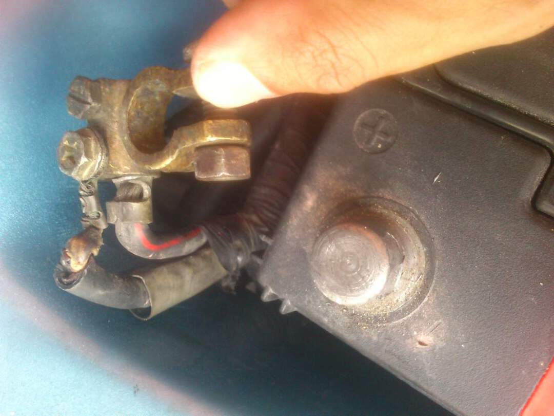

Open screw, put the cable in place & screw back at all the item listed above (it doesn't get any simpler than this :proud:)
attachment.php
attachment.php
attachment.php
And you're done
Don't forget to connect your battery back & test start your car :biggrin:
attachment.php
Happy 'DIY'ing
Gudluck :burnout:

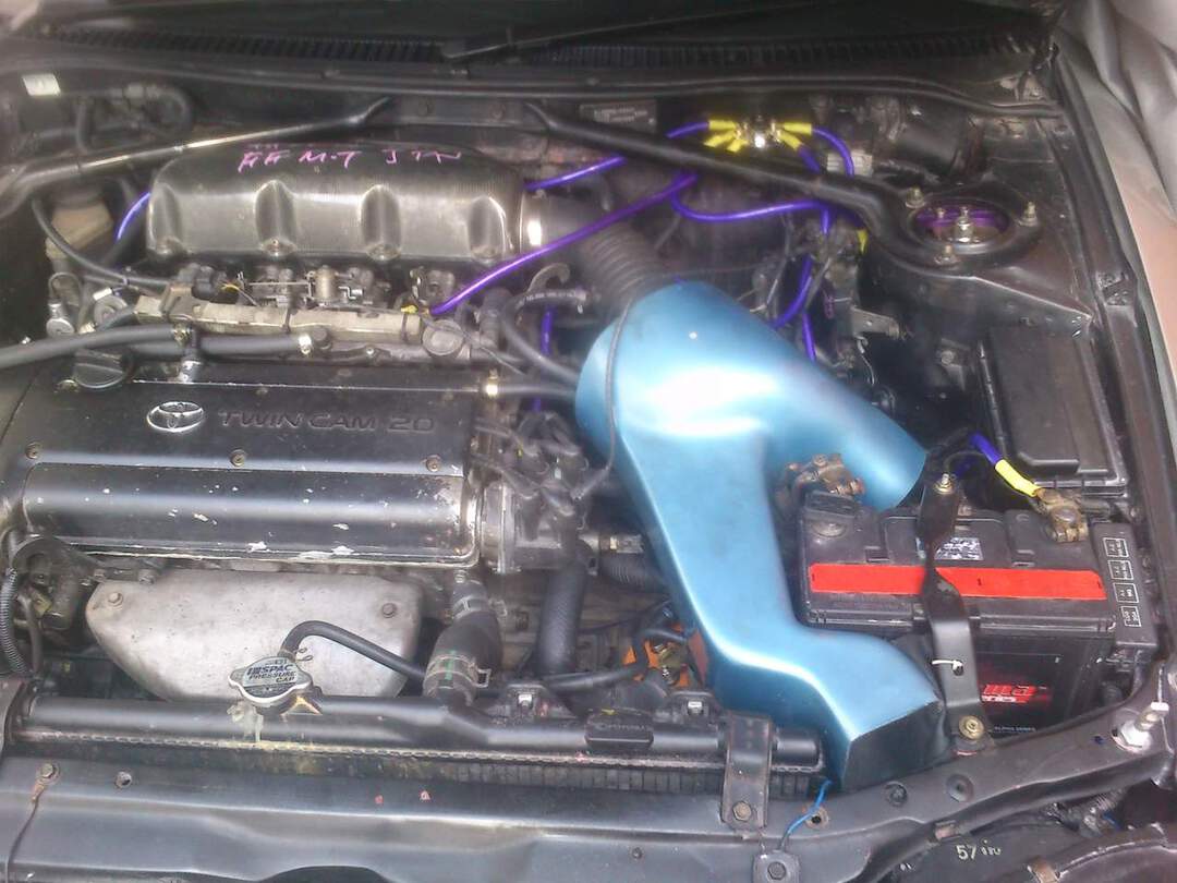

Hi all, i've did diy grounding cable previously in my engine. Bought un-cut wire at kedai brothers gor rm9.90 only.
Lenght about 7 meters. Need to measure, cut and crimp the terminal.
attachment.php
Happy 'DIY'ing
Gudluck :burnout:

Here is a pic of my GC...
