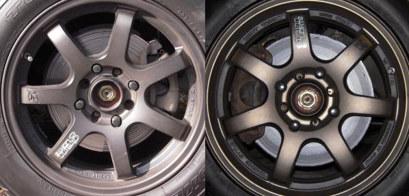

newuy..the mountings on the body no need to mod? H22A can fit into 15" rims kah? looks like cant fit oni...

mounting near gearbox ada sikit sikit..ur mechanic should know.
as for H22a brakes(prelude BB4) into eg.
original eg is 262mm rotor(4x100), intergra 96 spec type r also 262mm(but 4x114.3)(from halfcut dc2 type r 96-spec)
but H22A from prelude bb4 is 282mm rotor(4x114.3) and the brake pads is EK9, Dc2 98 spec shape/size.....only difference is the EK9/DC2-98 is rotor = 5x114.3 while prelude is 4x114.3.
its easier to get EK9 size brake pads.
here is the pic of brake upgrade...a few hundred bucks upgrade is affordable compared to a few thousand for those aftermarket brake kit

How abt Accord CD6 brake caliper??is it same with Prelude BB4??
