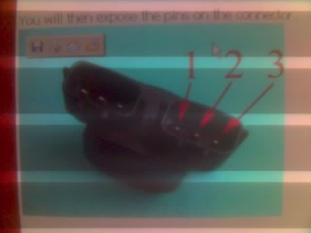

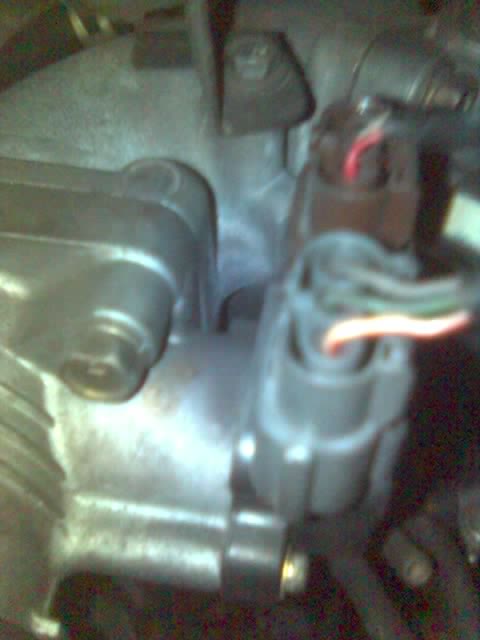

it is directly attached to the throttle body . it come with 2 connectors wires with six pins of which 2 pins for power , 2 pins for signal and 2 pins for ground. One of the connector is linked to the auto trans ecu (changes gear after receiving signal from tps).
The tps however could be adjusted slightly if your idle is out of range ( by a pro. technician). If adjustment does not relief or help the rough idle or slow speed, the unit needs to be replaced and adjusted again accordingly.

Does TPS affects rough idling or cause vibration, as i know it will affect idling range (too high or too low). I have checked its voltage at closed Throttle and full throttle position, it is within the range (0.4 and 3.96).
