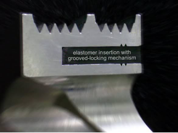

guys is there any of us from engineer background?
as we know there is a crank pulley price at RM600+
as they claim the rubber damper help to absorb and dissipate the vibration.
material use by this crank pulley is T6 6061 aluminium alloy, as we all know this material is light and very strong(stiff)
does this rubber damper really works? how long this rubber can last....
most of the aftermarket maker is use full alloy
i'm not complain their product but just feel abit over price....
All of our oem crank pulley have built in damper for damping and impact purpose. Like everybody knows, OEM designed stuff are meant for reliability. However, some of the market does not include the damper in their LCP due to cost reduction for better competition of market price. But some of them do, like metheodogy(spelling correct kah...?) Which is why makes it expensive.
Without the damper, things still works. But watch ur crank/pulley lar...
