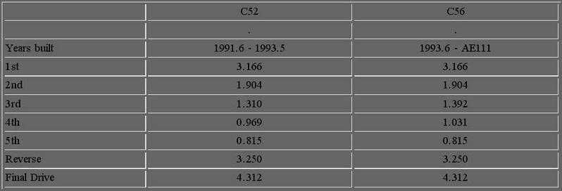

You stated the TRD close ratio for every gear. Can anyone list down the original gear ratio for 5 speed to compare?
TRD Close Ratio Original Gear Ratio
1st:2.222
2nd:1.850
3rd:1.600
4th:1.435
5th:1.292
comparison of C52 and C56....
Ya. According to the gear ratio, I think it's for more DRAG use...:biggrin:
