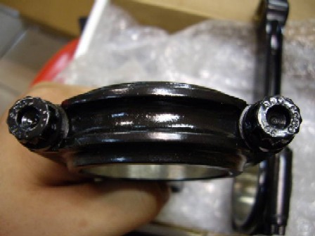

update 5/3/07
And update for the guys following this thread.
I ordered for a forged I-Beam rods to be custom Teflon coated but was instead sent a set of Forged H-Beam Teflon quoted. Bloody americans didn't even tell that the I-Beam no stock for few months. I-Beams were lighter but H-Beams can withstand more abuse.
Anyway, if you guys wonder why i coated them, it's cause proven in USA that the coating repels oil giving less oil windage power loss.
Wanted to coat my crank but work out the cost to be too expensive to send to USA and back to Malaysia.
This forged H-Beam custom coated has ARP 2000 rod bolts installed and they are slightly thicker than Eagle rods so they will take more abuse and stronger than Eagle.
See the below pictures:-
So what make are they? And how roughly would it cost for the avg. Malaysian? Super expensive or...????
As for the H-beam and I-beam designs, lighter vs. stronger eh? That's something new.. I always though they were a gimmicky design feature, with either providing better performance than the other.
They are custom made for USA. Without coatings they are priced very competitive to Eagles but with coatings they will cost about RM600 to RM800 more. I suspect they come from similar factory as eagle or eagle competitor.
But these are design to be beefier than eagles.
H-Beams are cheaper to make and design due to the processing difference of the two. Generally H-Beams are stronger to withstand more power hence normally used in turbo engines.
I-Beam/A-Beams are harder to make and processing them are more expensive, but they remove more weight or shift the reciprocating weight hence are generally lighter. A popular design among NA/All motor applications. But normally can take less abuse but for NA application is more than enough.
