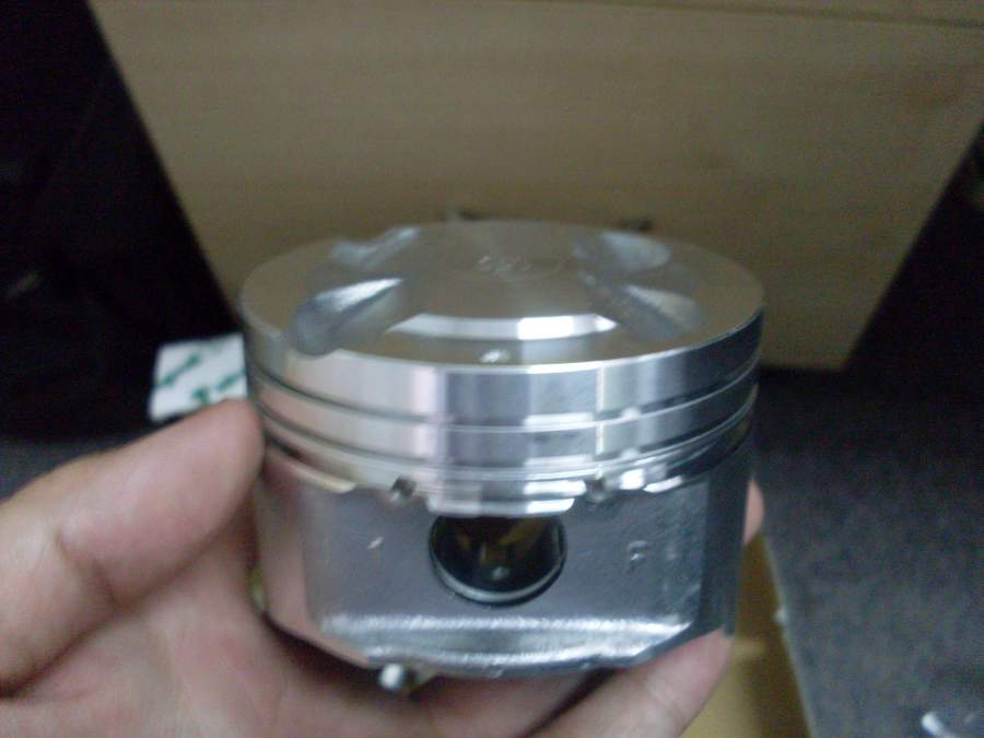

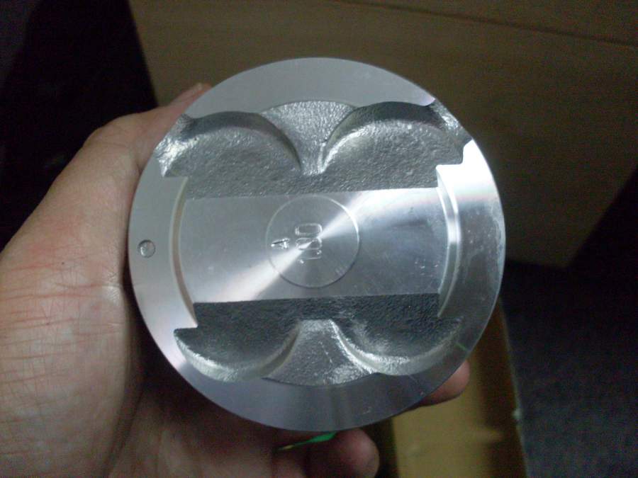

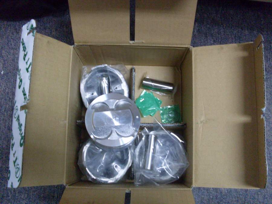

my brand new 84mm..
havent send to machine shop yet...
shinny :love:
dear steady mat rock...
20b = 89mm stroke
18c = 87mm stroke
reduce cc...
u can calculate ur displacement by :
(bore divide 2)(bore divide 2) X 3.142 x stroke X 4
hope this helps....
con rod stick the same..coz block height is the same..
